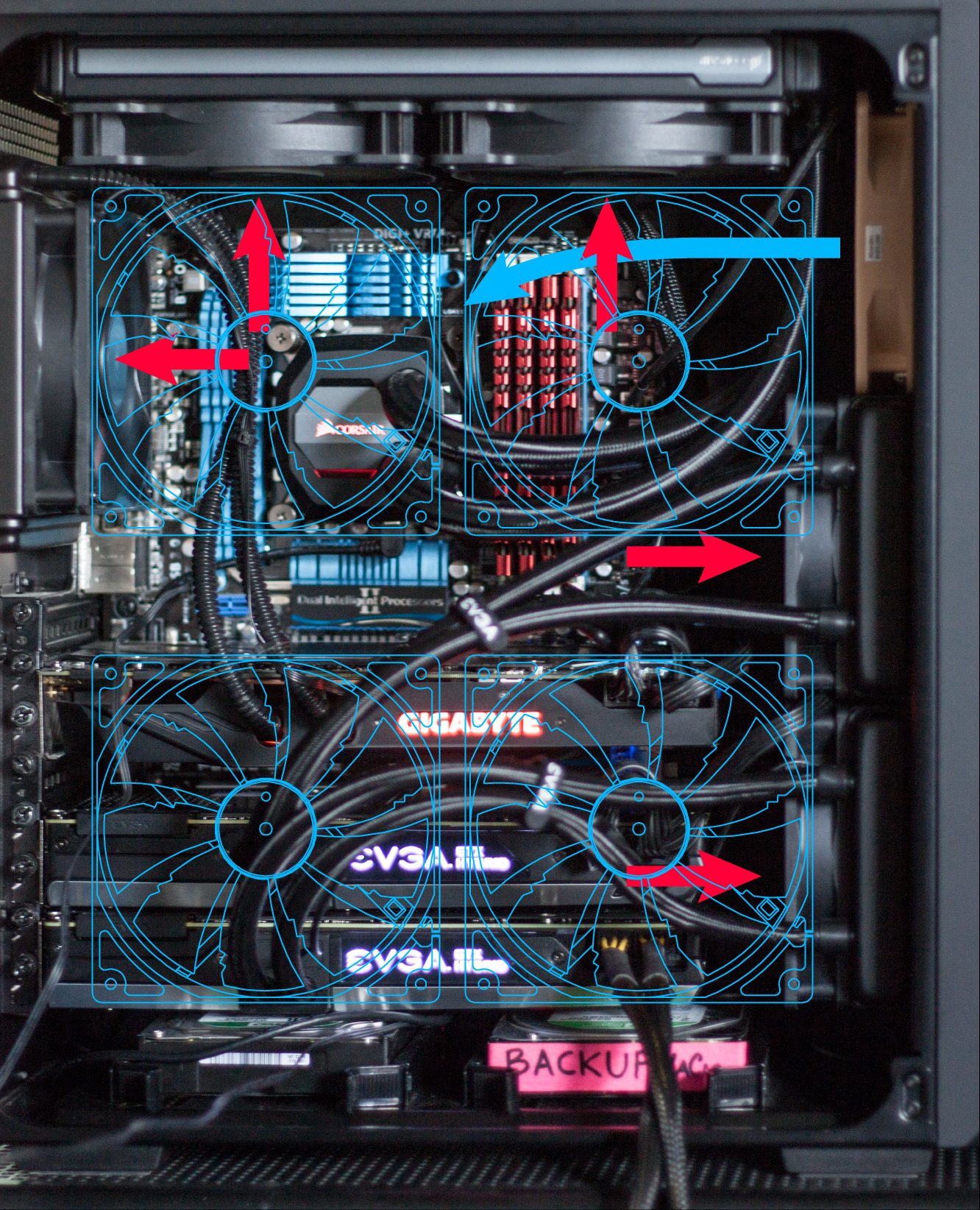

The most important part in a hybrid system, for me, is where the radiators are placed, and how, I put them all in extraction and I provide fresh air from the side door, which I modified to accommodate four 140mm fans for intake.
The system performs well, the cards reach a maximum of 45 ° at full load, and is not so much noisy.

Wow Liketheriver, that looks like a beast! Interesting approach for the radiators.
Seems like the most challenging part for me right now is finding the right case to fit the CPU rad + 4 Hybrids. My main concern is definitely, will the hoses for the hybrids reach the walls of the case. I was looking at the Corsair 900D case, but I don't think it'll reach considering the length of the hybrid hoses...
