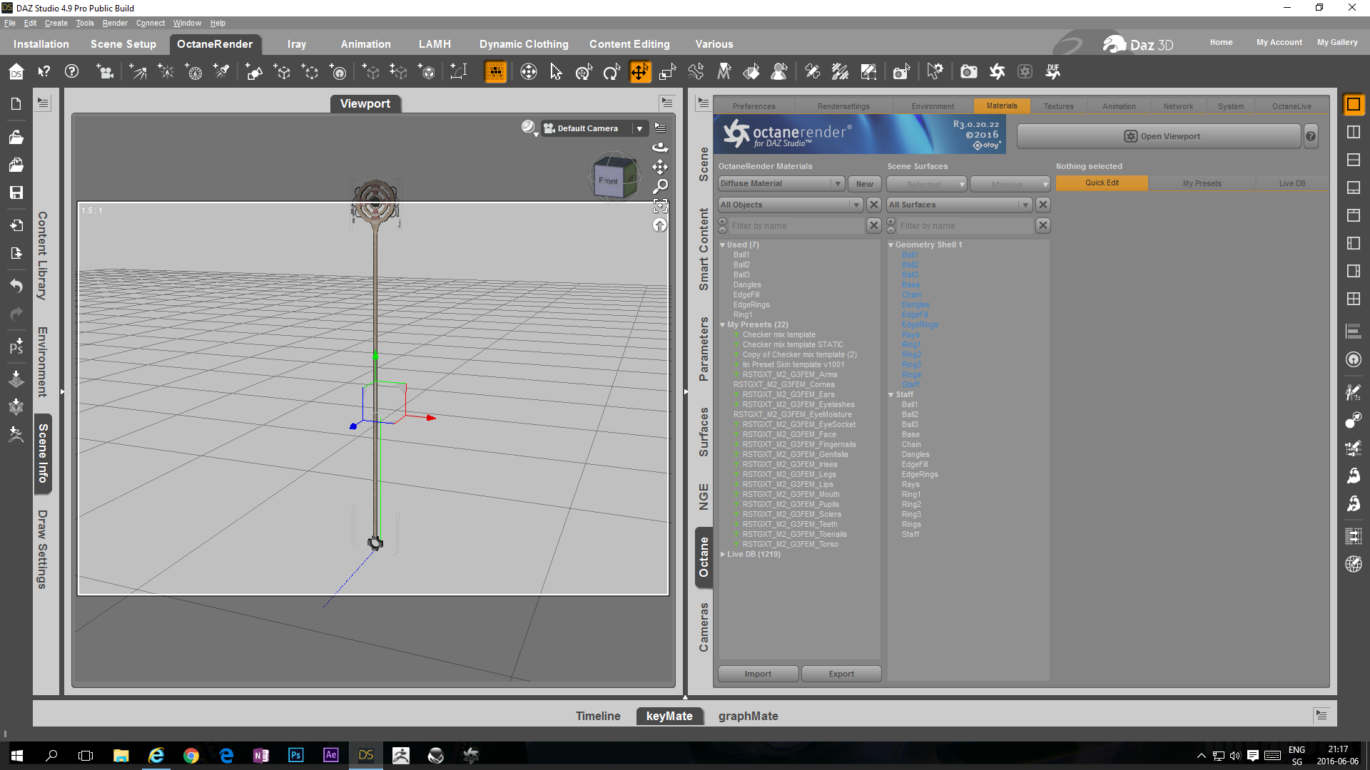

- "Frozen" means you cannot interact anymore with OcDS in any way.
- The OcDS user interface seems to change the color like there is an additional layer below or above.
- you can also not anymore use the DAZ Studio command to create a "New Scene".
Other interactions with DAZ Studio seem to remain possible.
Other tests performed:
Tested with other objects that have multiple surface zones so far all seem to trigger the same OcDS freezing effect.
When you have the materials tab open you can notice that the geometry shell and the multiple surface zones are added to the surface tab but after that OcDS stops operating.

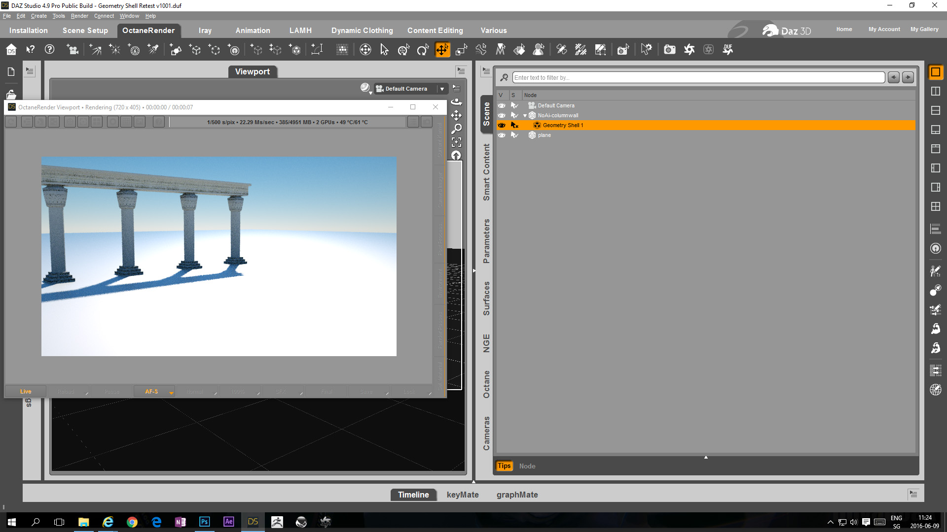

If you create a geometry shell of an object with more than one surface zone OcDS will lock up (freeze).
Object Selected in Scene - New Geometry Shell
Geometry Shell Options
OcDS locked up and not responding anymore after geometry shows up in OcDS viewport
-> You can see that the OcDS viewport locked up because rendering stopped after 1 frame.

:!: It can be hard to actually tell if a geometry shell was created because it is placed in exactly the same location and position as the original object.
A great test if a geometry shell was created is to select the geometry shell in the DAZ Studio scene tab and then move it around with the DAZ Studio Translate tool.
OcDS locked up - Geometry Shell moved to a different position with Translate tool.jpg
Now you may notice that the Geometry shell position will not anymore be updated in the OcDS viewport.

Test:
Which of the material conversion modes AUTO, DUF, MAN are triggering a lockup of OcDS when geometry shells with multiple surface zones are loaded?
Auto mode
"Automatic material updates after content loads" checked
"Load OctaneRender materials from .duf presets" checked
-> geometry shells of multi surface objects load without issues
Speculation: Immediately after loading a geometry shell into OcDS a material conversion is performed as expected.
Man mode
"Automatic material updates after content loads" not checked
"Load OctaneRender materials from .duf presets" not checked
-> geometry shells of multi surface objects load without issues.
Speculation: Maybe because no material conversion is expected to happen at all at any time during loading maybe OcDS is not expecting a material conversion when the geometry shells are detected and added to the OcDS surfaces tab? Therefore OcDS is not waiting for any command and scene is loading as expected.
