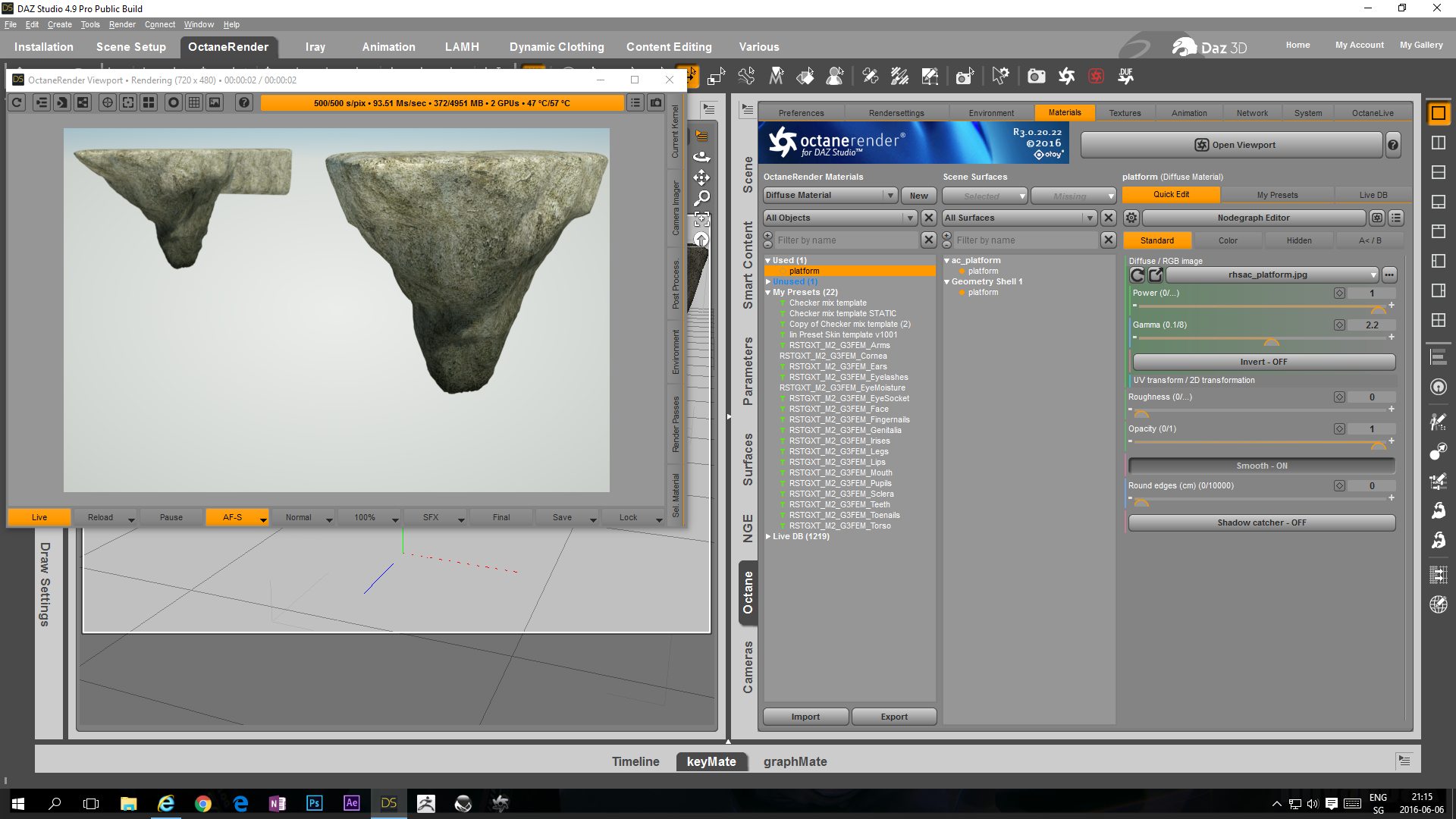

- Select the geometry in the DAZ Studio Scene tab
- Create / New Geometry Shell
-> A geometry shell is placed on the same location as the original
- Use X, Y, Z translation to place the geometry shell at another location in the scene
- OcDS material autotranslation will create a default material
- Drag the material of the original on the geometry shell
Note:
The Geometry Shell will not use any more VRAM than was already used by the original
-> OctaneRender is able to detect that the textures and the object of the geometry shell are duplicates

Is it possible that on your installation you have a template that is being applied to the duplicated shell which is causing the freeze that the rest of us do not have? Or the object you are duplicating has previously been saved with Octane data attached to it? Or perhaps your plugin Preferences have an option set with the rest of us have not got set which is triggering the problem? Applying the IRay material is causing an Octane material reload/re-conversion which is pulling it out of the frozen state.Just applying a new diffuse color to the geometry shell or changing its position does not have any effect on the "freeze" status of the OcDS plugin.
Nevertheless, applying an Iray Uber base shader does seem to trigger some kind of action that causes the OcDS plugin to get unlocked again

Thank you DrHemulen for providing feedback.
It is extremely helpful in such situations to have feedback from other users to narrow down why one user observes the behaviour and others not at all.
Which setting is preventing automatic material conversion after loading?
Which setting am I using all the time in my workflows that might be ignored by other users?
In short the result of further testing:
When loading geometry shells with multiple surface zones while in DUF material conversion mode a locked state of OcDS is triggered.
Longer version:
Test:
Which of the material conversion modes AUTO, DUF, MAN are triggering a lockup of OcDS when geometry shells with multiple surface zones are loaded?
Auto mode
"Automatic material updates after content loads" checked
"Load OctaneRender materials from .duf presets" checked
-> geometry shells of multi surface objects load without issues
Speculation: Immediately after loading a geometry shell into OcDS a material conversion is performed as expected.
Man mode
"Automatic material updates after content loads" not checked
"Load OctaneRender materials from .duf presets" not checked
-> geometry shells of multi surface objects load without issues.
Speculation: Maybe because no material conversion is expected to happen at all at any time during loading maybe OcDS is not expecting a material conversion when the geometry shells are detected and added to the OcDS surfaces tab? Therefore OcDS is not waiting for any command and scene is loading as expected.
DUF mode
> loading geometry shells of multi surface objects trigger a lockup.
Speculation:
Maybe this current combination of material loading and conversion options causes some unresolved issues.
- A material conversion should happen when loading user created .duf files that already contain OctaneRender material information.
- But no material conversion should happen when loading completely new objects into the scene.
Geometry shells may fall somewhere in between those criterias or may be meeting both of them because geometry shells are tied to objects already detected by OctaneRender.
This freeze or locked up state may just be symptom of waiting for a command what to do with that specific situation?
Can anyone else reproduce the described behaviour in DUF material conversion mode?
Your questions gave me an idea what to check and I was able to further narrow this event down...face_off wrote:Is it possible that on your installation you have a template that is being applied to the duplicated shell which is causing the freeze that the rest of us do not have? Or the object you are duplicating has previously been saved with Octane data attached to it? Or perhaps your plugin Preferences have an option set with the rest of us have not got set which is triggering the problem? Applying the IRay material is causing an Octane material reload/re-conversion which is pulling it out of the frozen state.Just applying a new diffuse color to the geometry shell or changing its position does not have any effect on the "freeze" status of the OcDS plugin.
Paul
