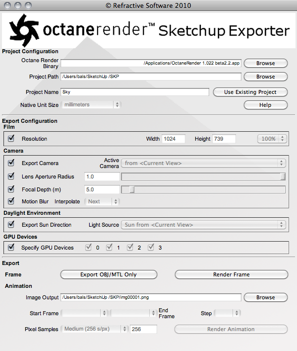

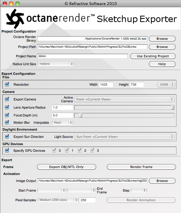

Can MAC users test it on a new SKP and see what the dialog checkboxes defaults to - initially they should all be unchecked except for the 'camera' checkbox which should have a tick... The text for the 'paths' etc should be auto-populated to match the SKP etc. Please can someone post a screen shot of the MAC's dialog as it is with this release...
There must be a cross-platform solution to this checkbox weirdness... So thanks for your patience :roll:

Well, it seems that you copy and paste your texts as I have to show the same images ;)
But would like to see if someone can test this with other Mac specs, so I can be sure that is not me doing something wrong. :lol:

I had hoped that this would at least start with ALL of the checkboxes UNchecked ! :cry:
I can simulate the problem with a PC by adding a 'sleep' before it does the 'populate' - then all of the checkboxes start out checked until after a second or two they fill in properly. This was in the last version, BUT in this kk version I changed all of the default settings and on a PC with temporary bit of 'sleep' code inserted it starts out with everything UNchecked and then it populates properly...

Hi TIG!
the very first time the plugin UI is all empty (both paths and checkboxes) for some seconds, then it becomes like the attached one.
I tried to close and re-open it and it remains all checked (as in attachment) from the start...

So at least I now know that the MAC is setting up the dialog properly at the start... but then its populate code runs and it goes awry and messes up...
This is not much, but at least something to go on... There are some known problems with SUp's API webdialog PC/MAC js callback etc etc but it should work or at least be fixable :cry: It looks like it's setting the checkbox values to false boolean but I suspect that its inner code [that I can't access] is setting the value to 'false' as a string which then is taken as a true boolean ! Aaaargh! :evil:
