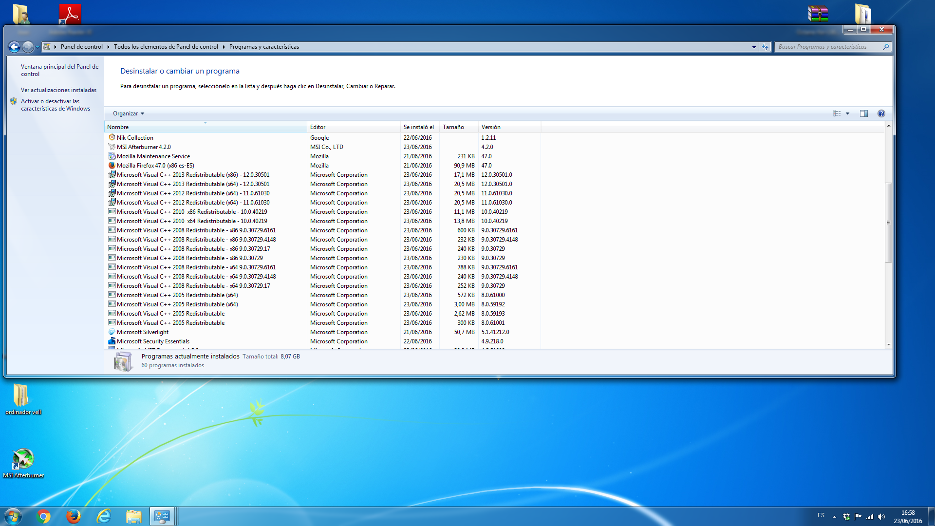

everything remains the same.
I have placed the plugin in another folder and still does not load.
I installed lightwave about 20 times and I have repeated the option to load the plugin again.
I checked microsoft visual 2012.
since they can not do more
