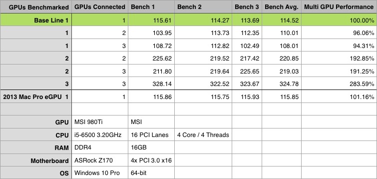

Ran a few test based on how many GPUs were connected at a time.
