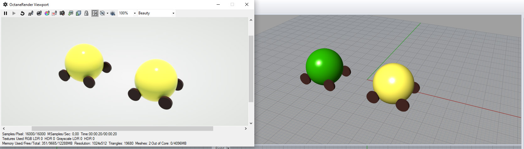

Hi Calus,
still I don't understand how the individual instances in Maya get there unique color and Rhino can't.
If I use the placement or scatter node in Octane standalone the material is assigned by the same geometry node?
How would this look like in Octane Standalone, then we might be able to apply this to Rhino.

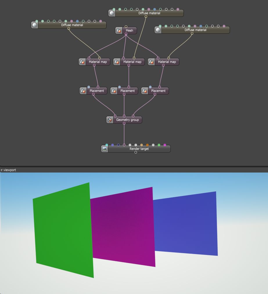

Refracty wrote: still I don't understand how the individual instances in Maya get there unique color and Rhino can't.
to have material per instance you need materialmap nodes between geo and placement:
1 plane mesh, 3 instances with each one its own material
regularInstance.orbx
(51.42 KiB) Downloaded 367 times

Thank you Calus for the mapper hint.
I will try to emulate this with the new nodegraph material in Rhino.
It would be awesome if Octane4Rhino would simply render the parent blocks with the correct materials automatically.

OK, just had a look at it.
I guess I can not enter the placement matrix of the individual objects since this is derived by Rhino.
So I don't see a way how to hack this in Octane4Rhino.

The OctaneRender for Rhino plugin uses a Scatter node to place block instances rather than a placement, the Maya approach is not possible.
