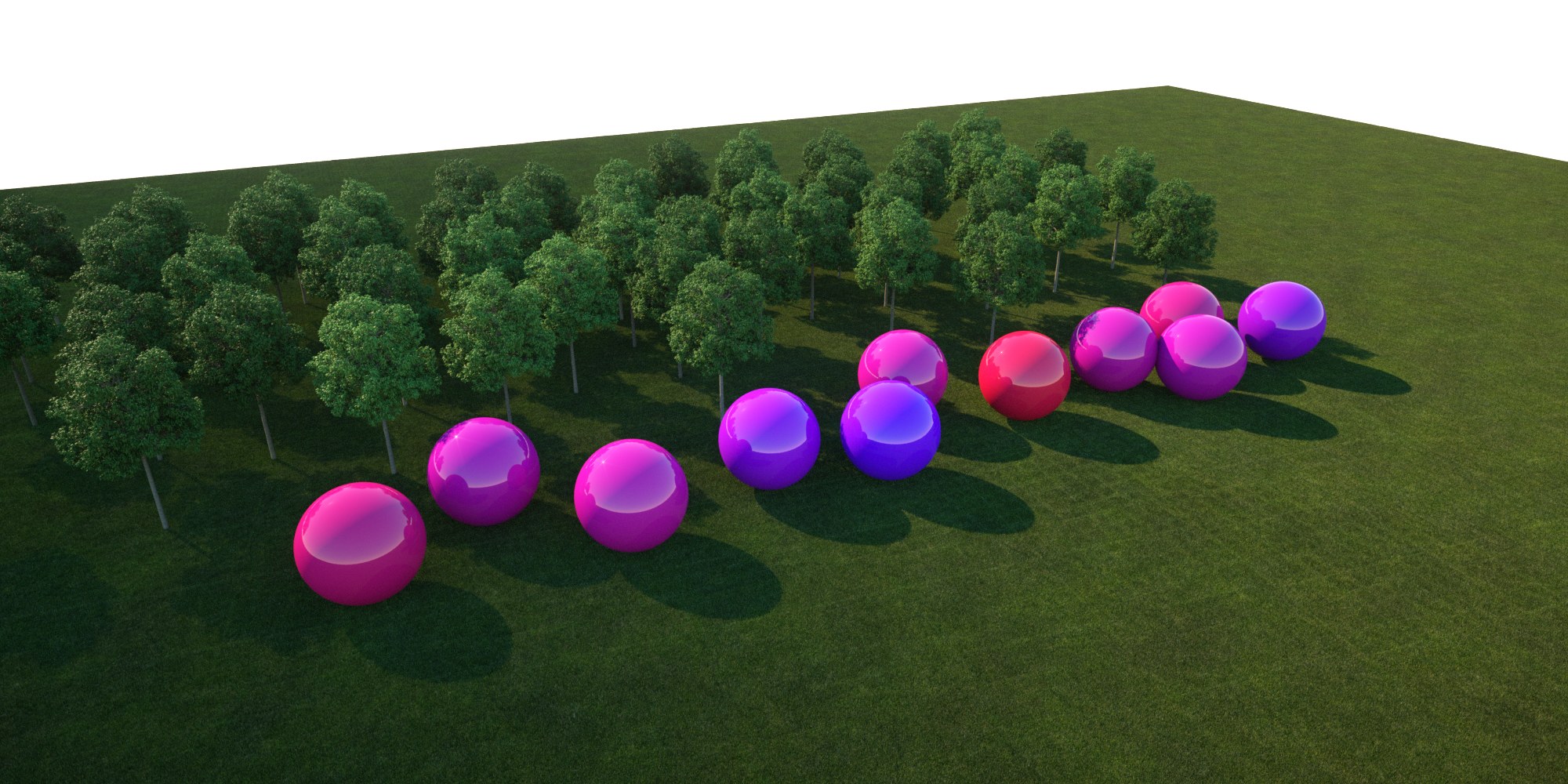

This is what I was able to archive in the last hour,
the trees use a multiply map with a base map and a scale texture consisting of a mix map with a) a grey color to adjust the intensity and b) the random color node
the spheres are using the gradient approach suggested by calus: gradient as a diffuse map, random color as base map and two color values to define the gradient.
@refracty : If you find out how to randomly use a defined set of colors please let me know, I would be extremly interested in this!

v-cube wrote: @refracty : If you find out how to randomly use a defined set of colors please let me know, I would be extremly interested in this!
Andreas, You can define a set of color with the gradient node, define different colors at different position and put "interpolation" to "constant".
What Refracty is looking after is a bit different I think, to be able to assign different Material per specific instance.
