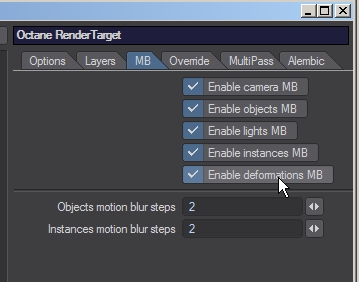

Do you have the deformations motion blur enabled in the render target root node options?

No, I enabled It only to test the Octane native Motion blur...Does It matter if I don't render the motion blur Inside Octane? Does It makes the motion data available to the vector motion passe?

Yes, you need to enable this option to get the deformations motion blur vector. If this option is disabled, the plugin doesn't extract the mesh motion data, so the motion vectors can't be computed.
