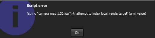

I did a find and replace using notepad++ then restarted Octane and attempted to run the script with the image texture selected and still getting an error in Octane 3.
See attached image:
leehenshall
Posts: 184
Joined: Sun Oct 25, 2015 5:44 pm
Location: England
Opps! sorry my mistake the fix does work. I just didn't have my render target selected/activated.
Thanks for the quick turn around roeland :)
