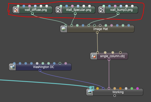

I have the following situation illustrated at end of post.
I am successfully looping through the material pins on a mesh node, identifying there type and getting some information. I was surprised I did not need to do anything specific to tell octane to look for external materials nodes connected to a pin. However I cannot seem to get to the texture file information from any node. Can someone please point me in the right direction. Current routine is included below.

For reference this is how you can find out the filename of the image texture used by the material:
Assume we have a material node matNode:
Code: Select all
-- get the node connected to the diffuse pin (skipping linker nodes)
local texNode = matNode:getInputNode("diffuse")
-- assuming T is an image texture node:
local filename = texNode:getAttribute("filename")
By default the diffuse input will have an RGB colour. In that case getPinValue can get the colour directly:
Code: Select all
-- now, assuming we have an RGB colour node:
local rgbColour = matNode:getPinValue("diffuse")
Roeland

Postby roeland » Thu Jun 02, 2016 10:06 pm
roeland Thu Jun 02, 2016 10:06 pm
  • getConnectedNode gives you the node directly connected to an input pin. This may be an input or output node of a graph.
  • getInputNode automatically skips linker nodes
So suppose for instance if you use a liveDB material (which will imported as a node graph) and connect it to a mesh. If you call getConnectedNode it will return the output linker node of that nodegraph. getInputNode returns the actual material node inside the node graph.
