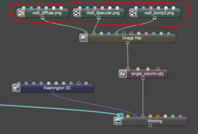

I have the following situation illustrated at end of post.
I am successfully looping through the material pins on a mesh node, identifying there type and getting some information. I was surprised I did not need to do anything specific to tell octane to look for external materials nodes connected to a pin. However I cannot seem to get to the texture file information from any node. Can someone please point me in the right direction. Current routine is included below.

After several hours I seem to have this working, so no help required at the moment.
