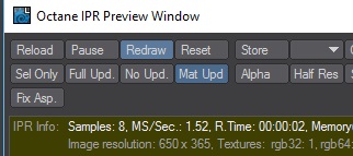

This is known limitation. The problem is that when you move the null object, the Layout doesn't launch a material update event, so the plugin can't know that the material must be updated.
The best workflow in this cases is enable the "Mat Upd" option in the IPR and press the "Redraw" button each time you need to see a change. The redraw feature is fast, and it will update the scene materials.

juanjgon wrote:This is known limitation. The problem is that when you move the null object, the Layout doesn't launch a material update event, so the plugin can't know that the material must be updated.
Thanks for the confirmation, I think that workflow would work best paired with openGL custom objects to allow for at least some visual representation of where the texture should be in real time.
