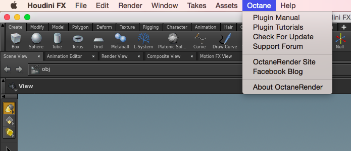

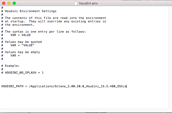

Sorry, but the installation instructions in the docs are written for Windows, Linux and OSX.
https://docs.otoy.com/Houdini/?page_id=39
Anyway, the steps to install the plugin in OSX are really easy:
- Download the plugin OSX .zip file. It has several plugin versions inside.
- If you are working with H15.5, you should extract the "Octane_3.00.20.0_Houdini_15.5.480_OSX" folder to any place in your HD. For example to your computer /Applications directory.
- As you have found, in your user home folder, the houdini.env file is located in "library/preferences/houdini/15.5/houdini.env"
- Edit this file, adding the HOUDINI_PATH variable pointing to the plugin folder. If you have extracted the plugin folder in your /Applications directory it should be:
Done. Now, after start Houdini, in the menu bar you should see an Octane menu, and in the shelf menu you should be able to find and add the Octane shelf icons.
-Juanjo
Code: Select all
HOUDINI_PATH = /Applications/Octane_3.00.20.0_Houdini_15.5.480_OSX;&
-Juanjo
