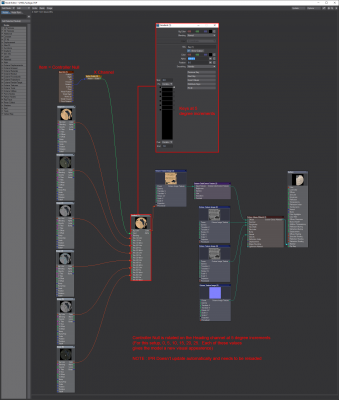

Hi all,
Would anyone know if it's possible to control an objects surface parameters using a null?
For example, I have an object for which I want to have several variations of (different texture maps applied), and thought that instead of having a bunch of different object taking up valuable storage space I could have a single object with all the texture maps applied using an Octane gradient and then linking the 'input' of the gradient to the rotation channel of a Null, so that when I rotate the null in (for example) 15 degree increments the textures change. The setup is pretty much the same as the random colouring of Instances, but the problem I'm having at the moment is that I can't seem to find a way to get the Nulls rotational information into the input of the Gradient node (incompatible LW/Octane nodes etc.)
Would anyone have any ideas?

Typically,
As soon as I pressed 'Submit' I had a thought, and it works. It's a bit of a Kluge setup, but once I'm done sorting it out I'll post a little explanation.
TheMightySpud
TheMightySpud

> dp kit / motion infopixeldelune wrote:Yes please mighty please let us know ur solution
or
item info > octane projection node> octane texture image
or
octane projection node / open XYZ envelope / modifier / add modifier/ Channel follower / click to your null
or
some other combinations...
try it
snip lwguru

Apologies,
I completely forgot I hadn't posted the solution. My bad.
As I said it's a bit of a kluge, but it works so I'm happy
The setup can handle as many inputs as needed, just adjust the gradient node to taste
The Attached image should explain it all. Any questions, please do not hesitate to ask.
TheMightySpud
TheMightySpud
