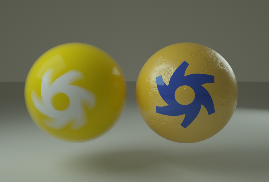

Try this
imagetex-logo.zip
(163.84 KiB) Downloaded 223 times
