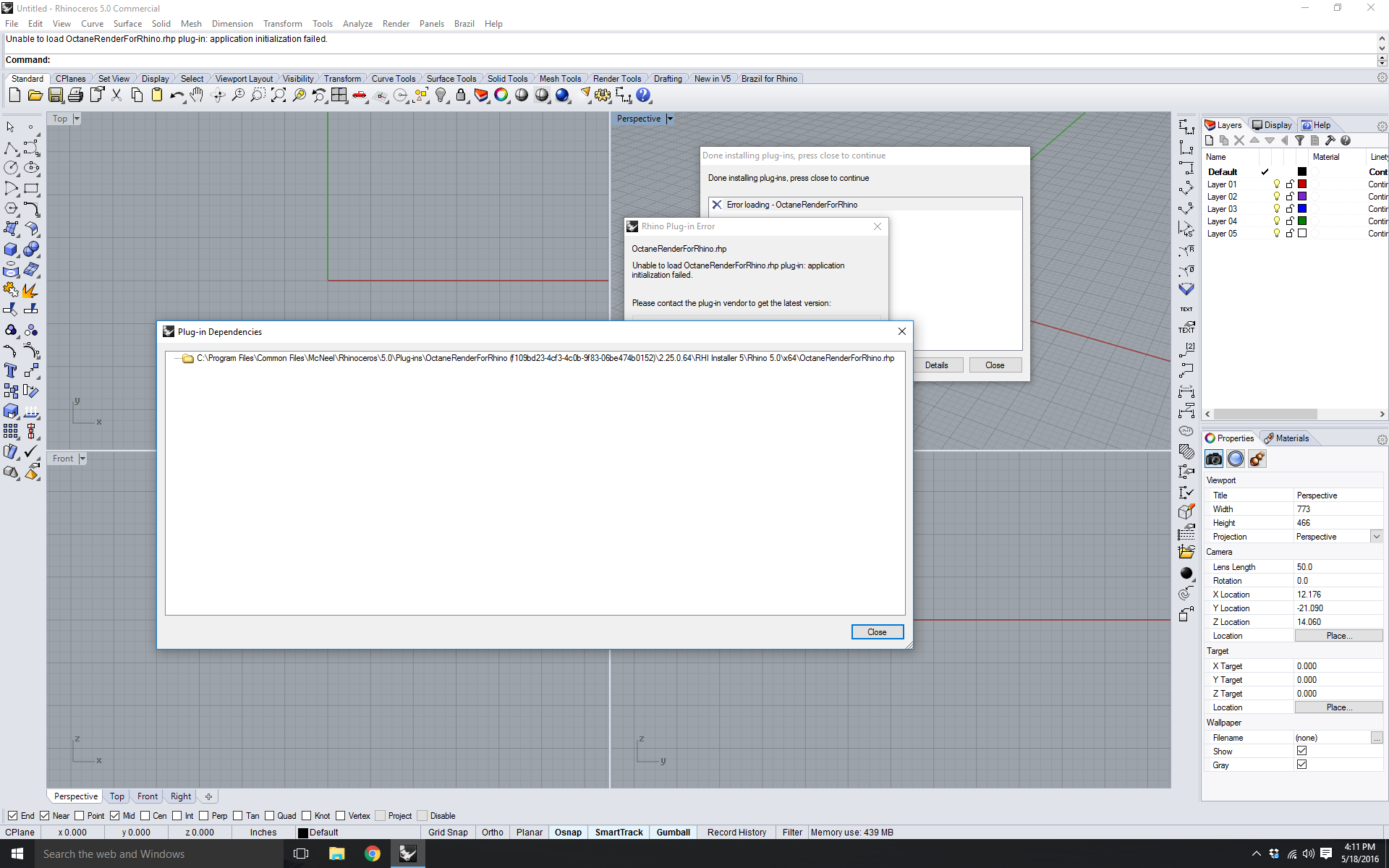

My Octane plugin for Rhino would not install when I opened Rhino 5 this afternoon (I've been using it with no problem before).
I've never encountered an issue before. (I was working in Octane standalone 3 beta 2 prior to opening).
I was using Octane 2_24_2_54 when it quit working, and then re-installed Octane for Rhino 2_25_0_64.
I'm on Windows 10. I also have Octane stand alones 2.24.2 and 3 beta 2 installed.
I've attached a screenshot for additional reference.
Many thanks for any assistance, I am in a bind.

Hi - I haven't seen this problem before.
Firstly, make sure you have uninstall the old version of the plugin that you would have installed via the old installer (as opposed to the rhi installer). To ensure this old version is uninstalled, make sure C:\Program Files\Otoy\OctaneRender for Rhino5 is empty.
If you have been running Octane Standalone beta 2, they perhaps there has been a licensing issue. So it would be worth installing and trying the latest Octane 3 version of the plugin from viewtopic.php?f=41&t=42587.

Even with the one initial folder: 2.24.2,54, the plugin quit loading when I tried to use it today.
Now, I also have the 2.25.0.64 & 3.0.10.64 folders.
No Octane plugin even appears in Rhino-tools-options-plugins. The plugin isn't loading at all when Rhino is started (but I get the afore-mentioned error message when starting Rhino).

I have never seen this problem before.
Something must have changed on your system to cause the issue (a Rhino update, Nvidia driver update, hardware change, plugin update). The error message is indicating the plugin was compiled on an incompatible version of Rhino. I am on Rhino 5.12.50810.13095 (so that is the minimum version of Rhino that you need in order to run the plugin).
Try deleting all the Octane folders from C:\Program Files\Common Files\McNeel\Rhinoceros\5.0\Plug-ins, then install the latest 2.25 version. If that does not resolve the issue, try re-installing Rhino SR12.
Also - install Nvidia driver 358.50 to discount some sort of Nvdida driver issue.

I followed all your suggestions, including a clean reinstall of Rhino 5 and I was still encountering the error.
What I found, that somewhere in my middle-aged madness, I had managed to "hide" my user folders in my C drive....ughhhhh...so after unhiding the folder almost everything appears to now work properly...
