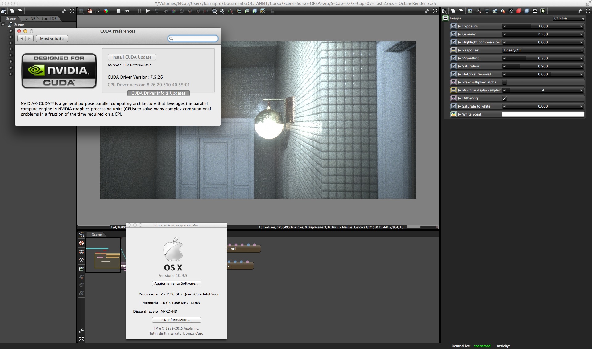

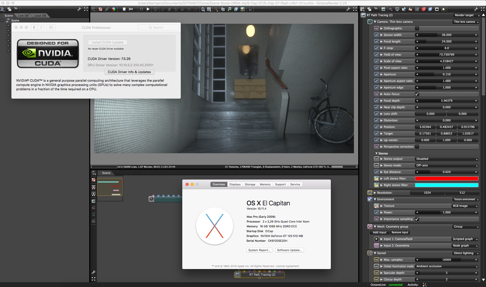

Hi magicroma,
weird, unfortunately I don't have 10.10 on my Mac Pro anymore, but I can run Octane 2.25 on 10.9.5 and 10.11.4 with no issues :roll:
10.9.5
10.9.5
10.11.4
10.11.4
As you can see, the CUDA drivers are updated to the latest ones, while the graphic drivers come directly from Os X, no special Nvidia drivers installed on both.
Which drivers have you installed?
You can go back to the original Os X driver by installing again the 10.10.5 combo update:
https://support.apple.com/kb/DL1832?vie ... cale=en_US
ciao beppe
