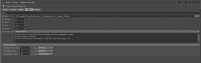

I tried a simple animation with a .vdb file in a volume and there's a cloud animation witch is too quick and not continus... at the end of the sequence, the cloud isn't animated.
I don't understand how work the cloud animation in the .cdb panel.

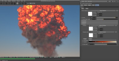

Hi bertritude,
here is the "fire part" of the explosion.vdb file with a texture emission node and a volume gradient node:
explosion_vdb_01.c4d.zip
(38.83 KiB) Downloaded 185 times
ciao beppe

it works great , th :D anks Beppe.
