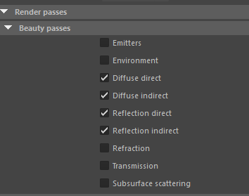

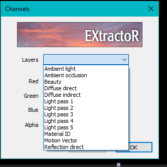

So I did a few tests.
Turned off all "beauty" passes except Reflection Indirect and hit batch render.
What came out was a pass in composite EXR title Diffuse Indirect, but this was actually the Reflection Indirect pass.
So I'm guessing, they are both getting written to EXR but reflection is being overwritten?

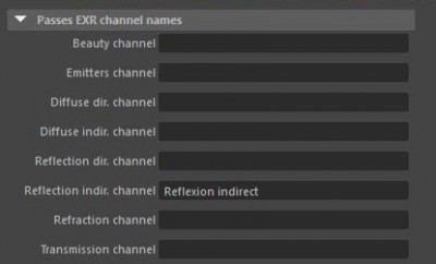

Right,
there is a mistake in the default names for composite EXR channels.
Reflection Indirect channel use the same default name as the Diffuse Indirect channel.
In the meantime you can address this by not using the default name for this channel.
like this:

Thanks.
Naming the passes explicitly did the trick.
Should've thought of that sooner
