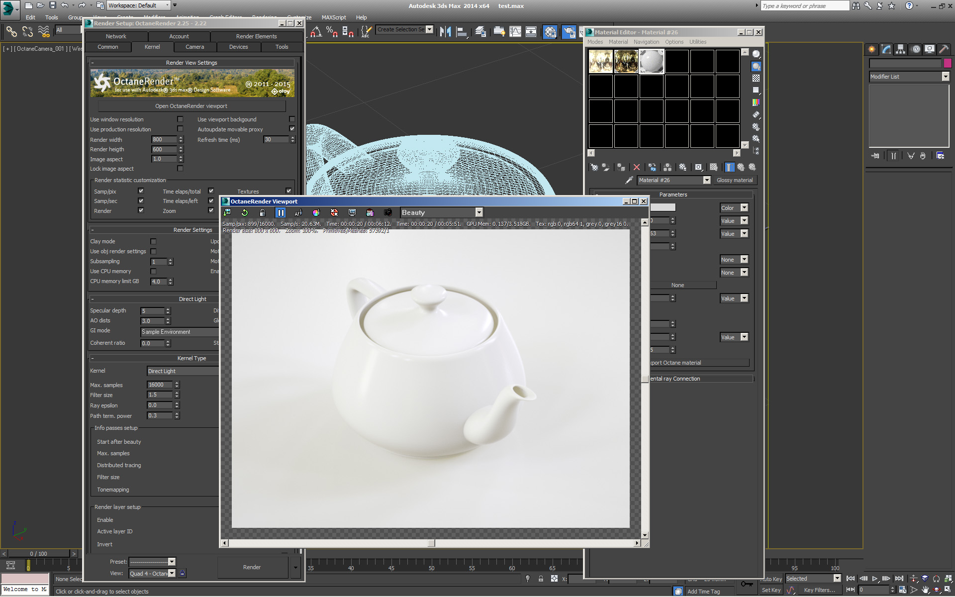

I get a full 3ds Max 2014 crash when I open the material editor when I try to add a Octane material. Max freezes to a halt, where I have no ability to close Max without killing it from a ctl+alt+delete. If anyone has a solution to this, any advice would be appreciated.
Note: I just got finished trying out the demo, which performed flawlessly. No crashes, odd behaviors, etc.
Win 7 64
Latest Nvidia Driver (Strix GTX980)
Standalone version 2.25
Max Plugin Version 2.25-2.22
