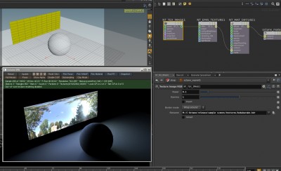

I have hdr image of real photographic lights and would like to map it on grid objects.
In 3dsmax it's quite simple to do:
Diffuse material > Texture Emission > RGB Texture image
But how to load RGB Texture image in Diffuse material in Houdini?

Postby juanjgon » Fri May 06, 2016 1:01 pm
juanjgon Fri May 06, 2016 1:01 pm
You only need to add a texture image node linked to the 'efficiency' emission input.
-Juanjo

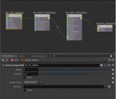

Postby Angelos » Fri May 06, 2016 1:12 pm
Angelos Fri May 06, 2016 1:12 pm
I treid to put in your way but it doesn't work for me.
Seems it's work in this way:
Version 2.25.0.1

Postby juanjgon » Fri May 06, 2016 1:15 pm
juanjgon Fri May 06, 2016 1:15 pm
Hmmm, true. This should work also. I am not sure about what is the difference, perhaps something related to the support of the projection nodes ... if it works now, go ahead ;)

But, are you mapping the HDR texture in a environment sphere? How is it mapped, with UVs?
If you are mapping the HDR texture in an obeject with an UV map, link the texture image node to the 'efficiency' input should work without problems, as you can see in the attached image. Also be aware that by default the texture image node has a 2.2 gamma correction, you should set this parameter to 1.0 for the HDR images.

Postby Angelos » Fri May 06, 2016 3:26 pm
Angelos Fri May 06, 2016 3:26 pm
Just three grids with UV. Changed the gamma to 1.0 and it works correctly.
