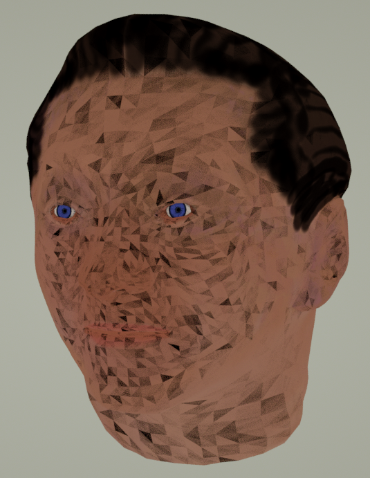

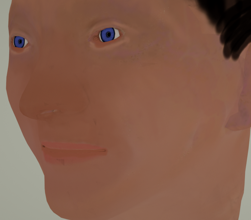

The title will find one use of the terms but was not helpful . When zoomed in it's all clear:
When zoomed out, this appears:
I fiddled with the Phong tag to no avail. This is the first occurrence.

Do you know "ray epsilon"?

Thanks, Ahmet, for a quick reply! I have never adjusted Ray Epsilon but I will dive in and learn about it.

Hi TonyBoy,
if you have to correct the rey epsilon value, especially with an object like this, it means that the scale is not correct. Since Octane is physically based, please, always double check you mesh dimensions, otherwise you could have other issues later on, i.e. with DOF, displacement, SSS or emission power ;)

TonyBoy
Posts: 238
Joined: Thu Dec 13, 2012 4:47 pm
Mille grazie,
scale was the problem.
Arrivaderci,
TonyBoy
