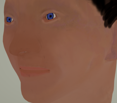

The title will find one use of the terms but was not helpful . When zoomed in it's all clear:

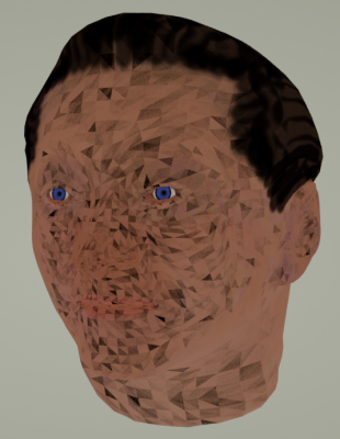

When zoomed out, this appears:
I fiddled with the Phong tag to no avail. This is the first occurrence.
Mystery Triangular Artifacts
Do you know "ray epsilon"?
Hi TonyBoy,
if you have to correct the rey epsilon value, especially with an object like this, it means that the scale is not correct. Since Octane is physically based, please, always double check you mesh dimensions, otherwise you could have other issues later on, i.e. with DOF, displacement, SSS or emission power

I had that trouble to, and fixed it with the ray epilson thing.

Hi tukor,
you should not worry about scale untill your meshes have believable measures. Problem comes if a brick has the dimensions of an house or vice versa.
If in a scene, for example, the subject is a tiny object, and then, the camera moves out to see an entire city, you can always animate the rey epsilon value
ciao beppe
