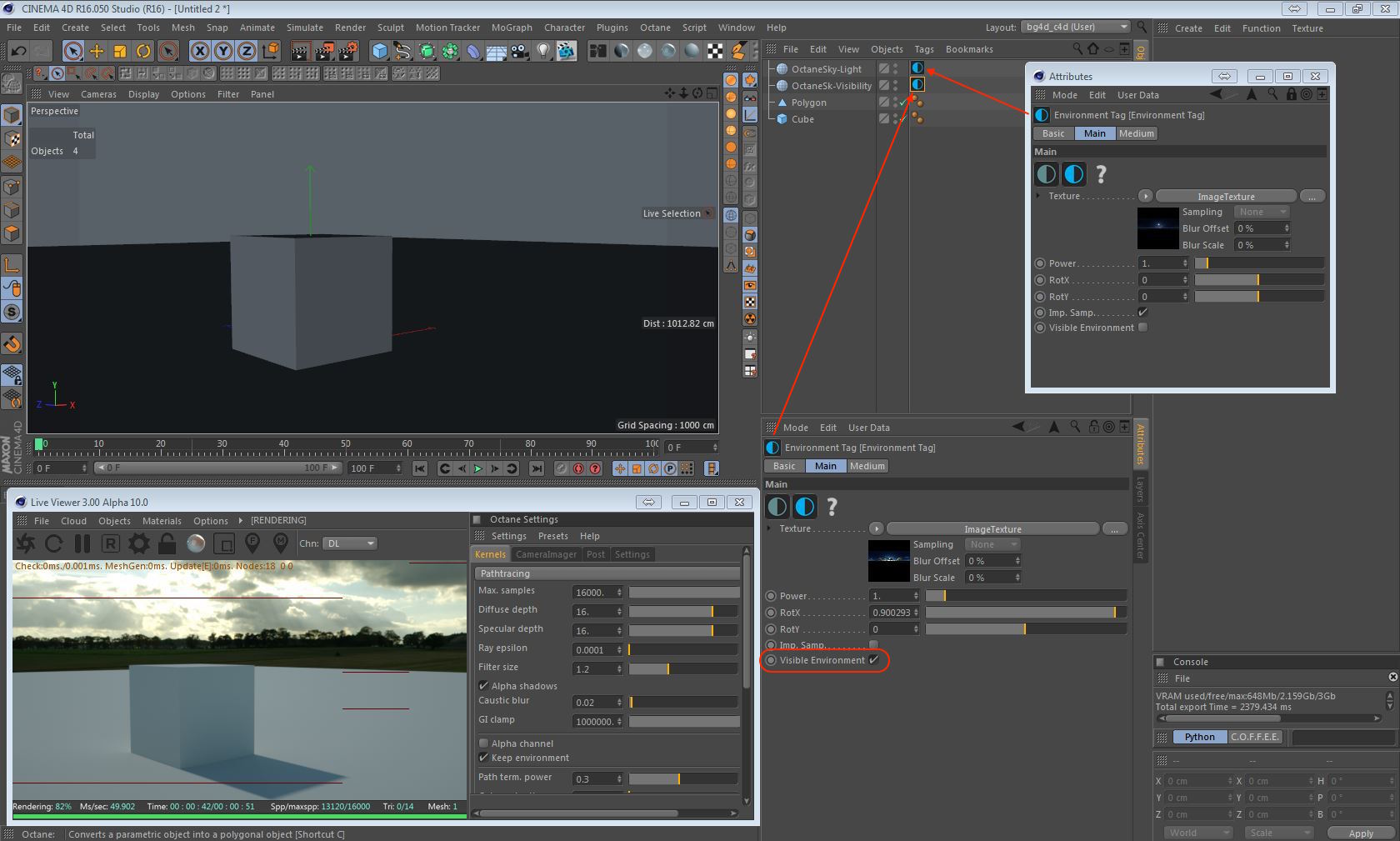

In the new v3 alpha 10 you can also use two different HDRs, or the same with different settings, one for lighting and the second one for visibility and reflections, give it a try
how work this two HDRI Solution in c4D. In my opinion is this the right way ^^

Hi vi-ex,
just create a couple of HDRI Environment objects, and in one of them, tick the Visible Environment option ;)

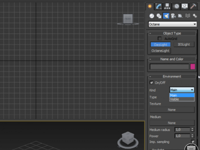

Any idea where that option is for the 3ds max plugin?
Posts: 10597
Hi Rik,
just under the On/Off checkbox there is a Kind option, Main or Visible:
ciao beppe
