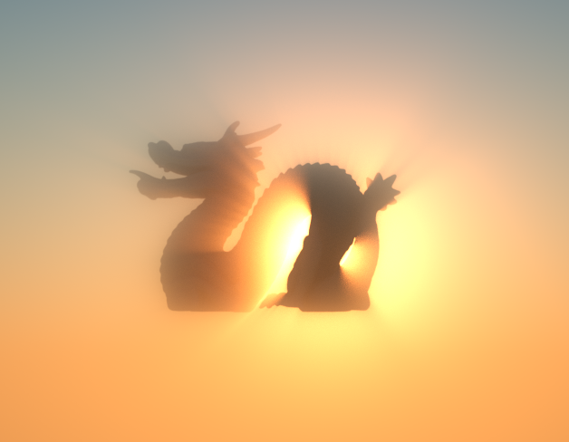

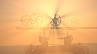

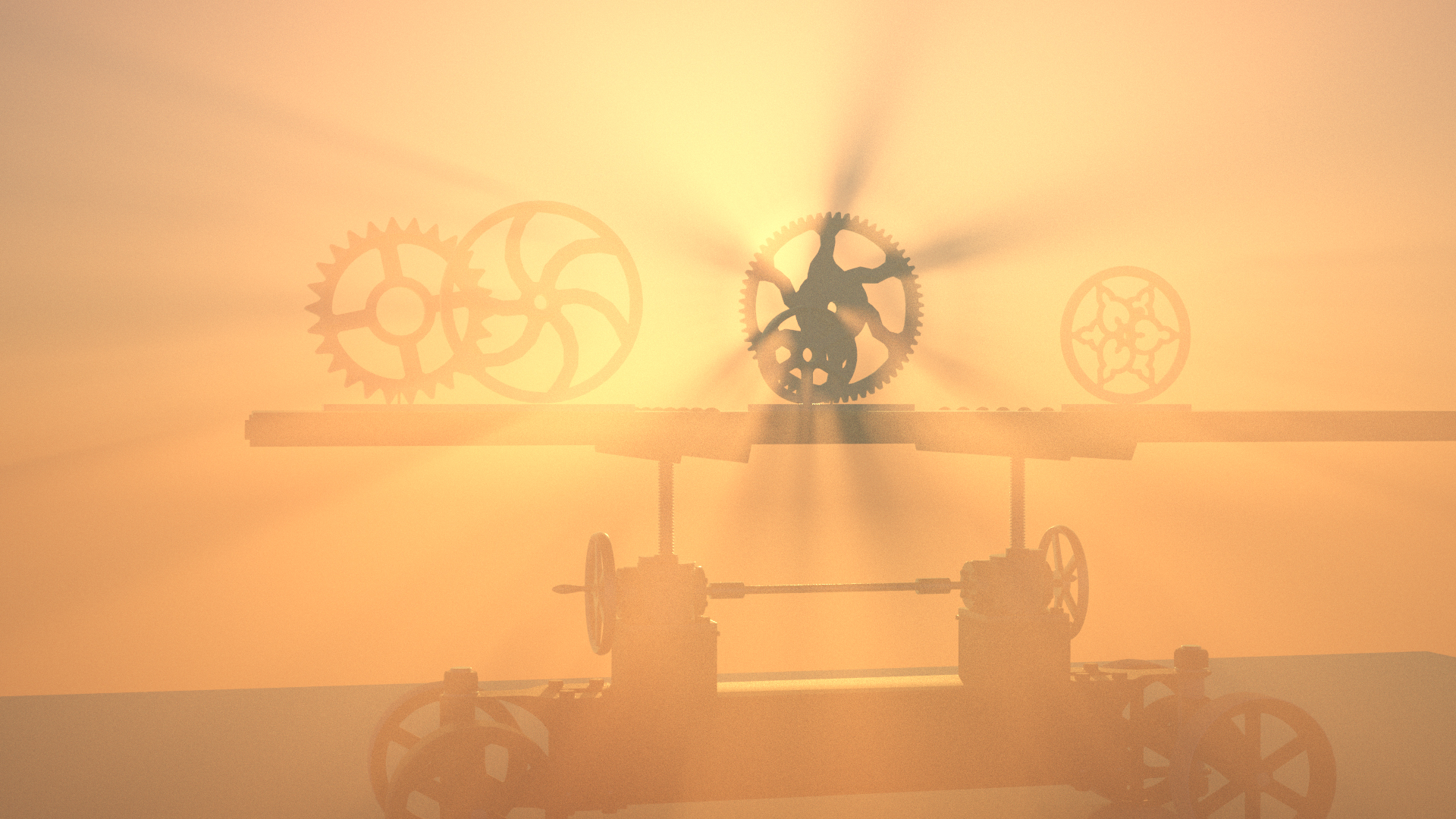

how to create volumetric light rays of the sun? alpha 3 I did it, now I can not see anything
Octane 3 alpha 3
haze
Posts: 1003
Joined: Sun Feb 08, 2015 8:57 pm
Elvissuperstar007 wrote:how to create volumetric light rays of the sun? alpha 3 I did it, now I can not see anything
Octane 3 alpha 3
Camera environment pin on render target - set scattering and change scattering direction to ~0.95
Send us the scene if it still doesn't work
lightrays.orbx
(29.49 MiB) Downloaded 320 times
