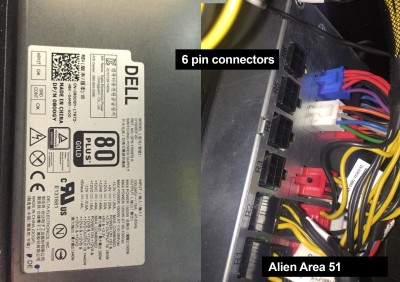

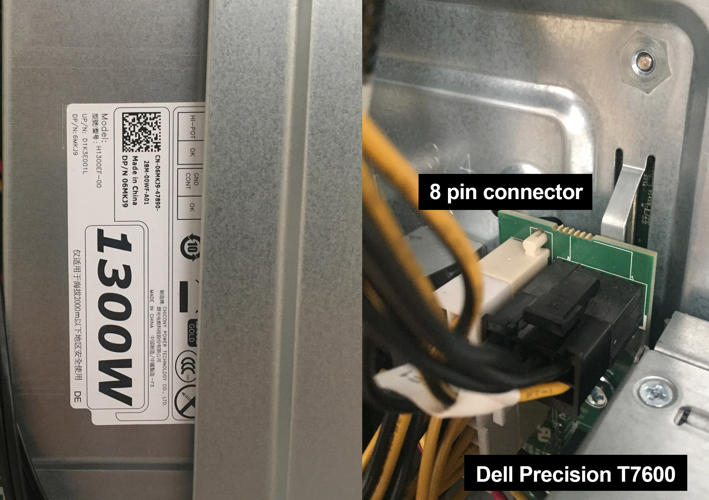

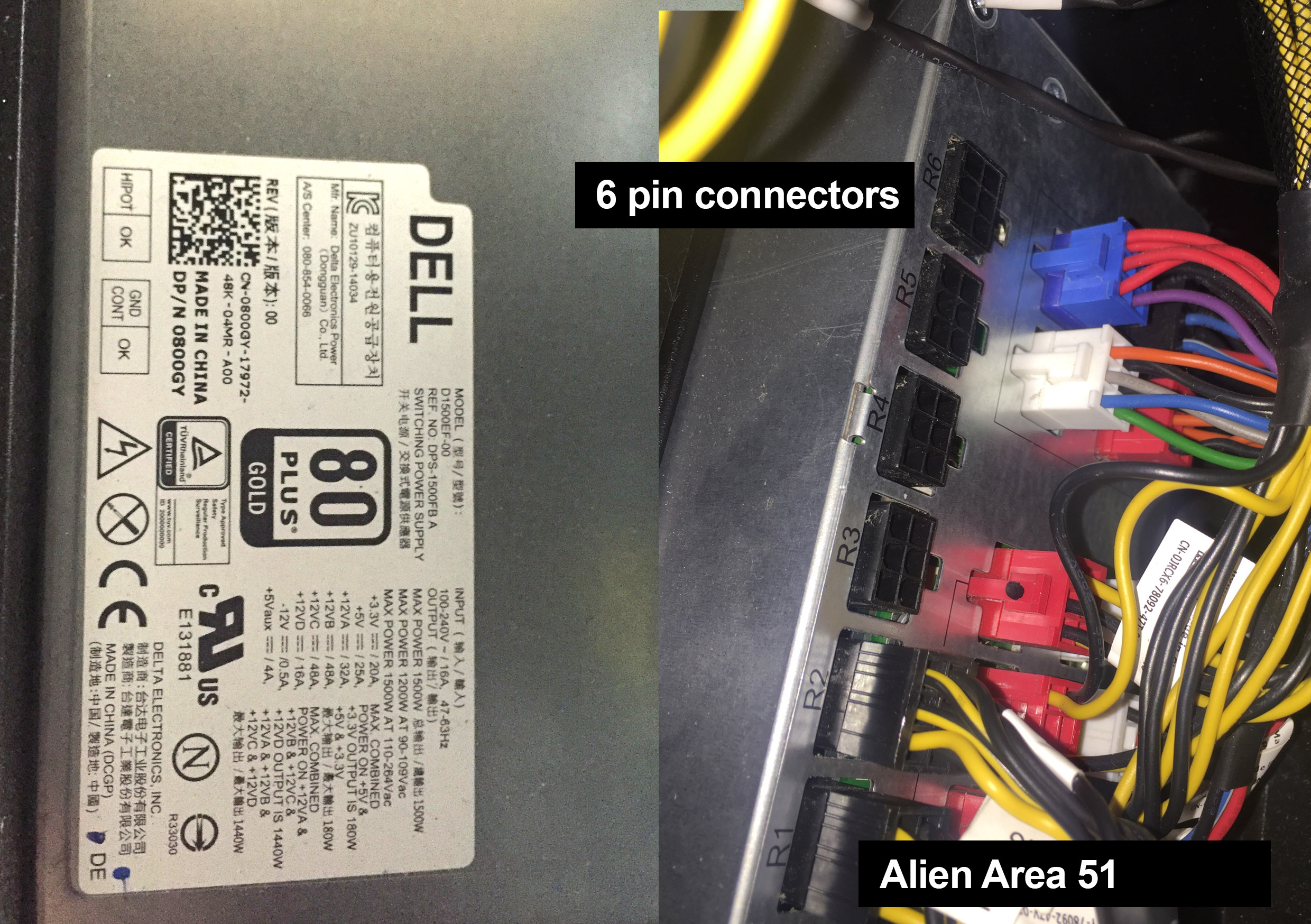

Thanks for the quick response,
Here are the two images of the PCU and the inputs.
There's 3 x 8 PCI on the Dell
6 x 6 PCI on the Alienware
glimpse
Posts: 3740
Honestly, the price per cable is not entirelly unreasonable, considering as mentioned that all cables differ (apart from the side that plugs into GPU, motherboar, 24pin - those are standard). So if Yo uwish to get exact cables You have two options, buy or make them =) price wise getting from DELL might be even cheeper than making from scratch =)
