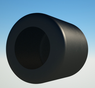

i'm having this problem
whenever i have an open mesh, for instance when i keep the invisible part with no polys; i see through it, like it was a bit transparent
i can see the background or the lights through it
any solution for this? i searched the forum but no luck
thanks in advance!

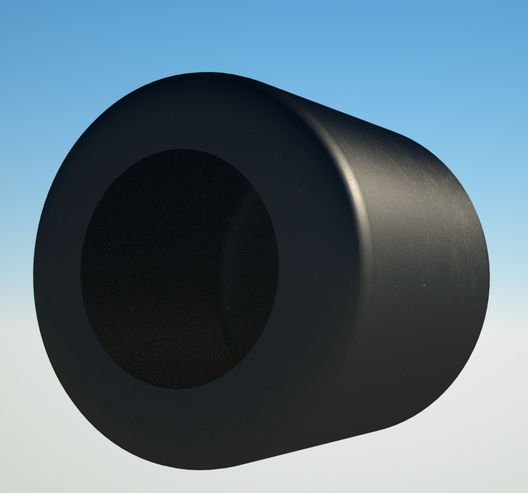

hi,
as you can see i can see the hole through the mesh even if the material is not transparent
any suggestion? i'm sure is some dumb mistake I've made
thanks!

Thanks for sending through the file. The Opacity of the First Material in the Material Mix is 0.968, so it is very slightly transparent. Set the Opacity to 1 and the mesh is no longer partially transparent.
