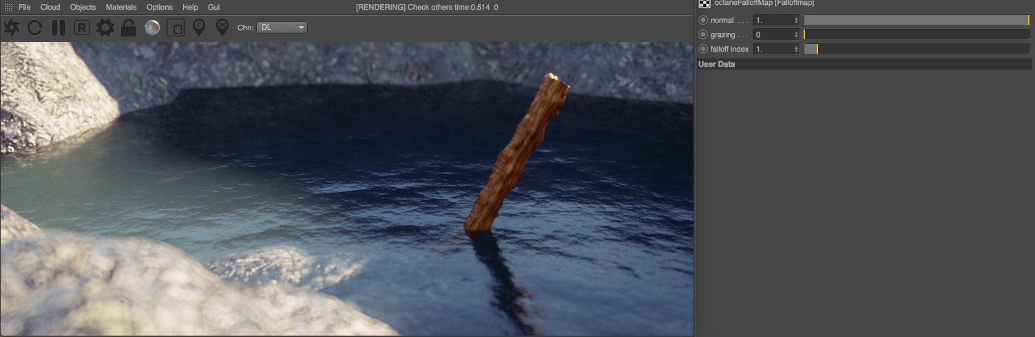

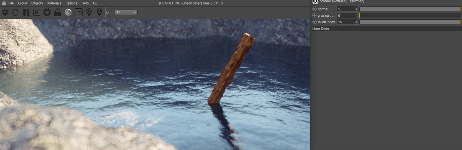

here is my attempt, almost the same principle as Hesekiel2517 but with a falloff node only in reflection of one specular material. Firstly I have inverted the Normal and Grazing values.
Falloff index = 15 :
Falloff index = 1 :
ciao beppe
