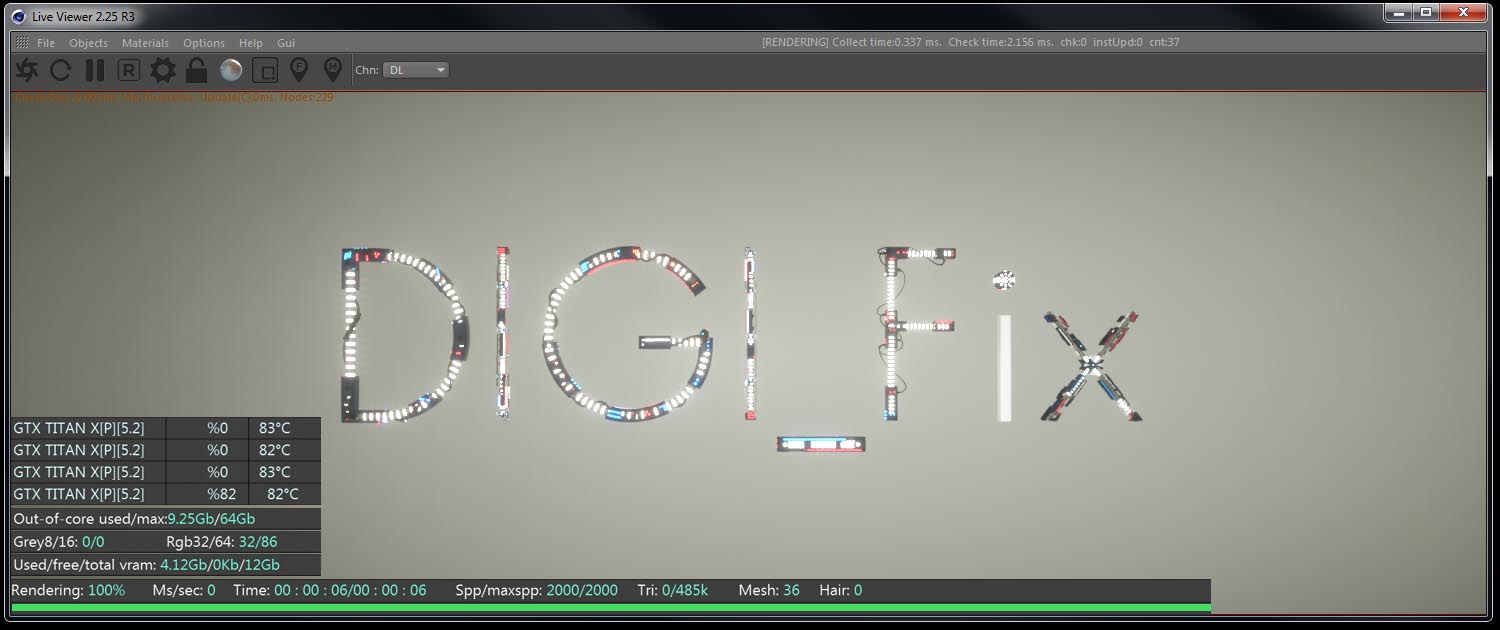

I manage to fix the issue. It was related to my nvidia drivers, one update and up and running.
Tried to access null item
Export materials time= 112764.369 ms
Collect objects time= 0.346 ms
Mesh creation time = 121.282 ms.
Triangle count:485k
Total export Time = 173074.391 ms
So, if I have triangles in my scene that is a bad thing ? I'm very careful with that, specially for deformation, but hard surfaces, not so much, specially if is not a close up.
Thanks guys !
