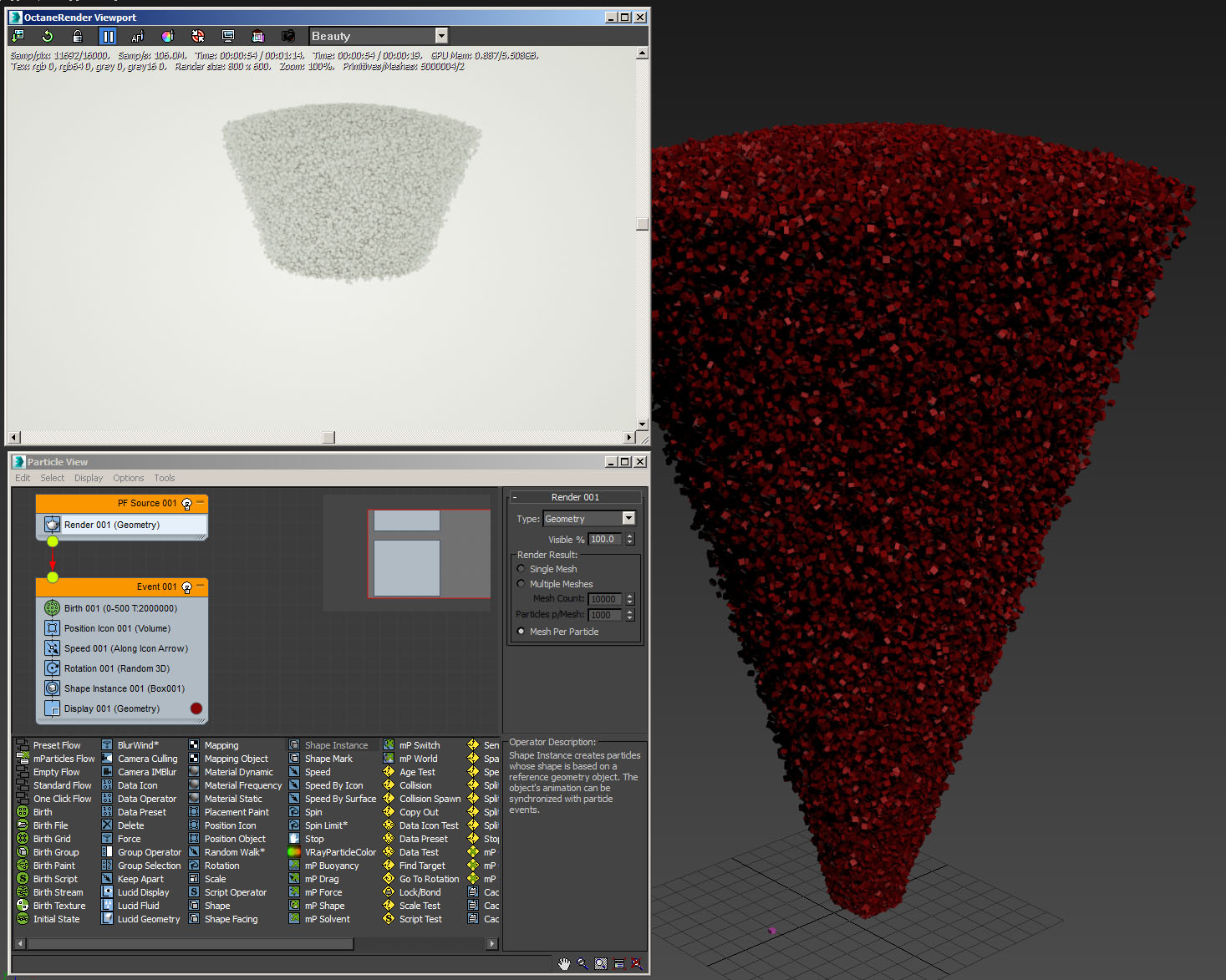

Hi, thanks for answer...
Here is a screen grab of my problem. My computer is a i7 5930K 32 Go ram, one Titan, and one Titan X.
Octane render version : 2.24.2 - 2.13.
Thanks for that. That bug does seem very curious. I will attempt to replicate this on a similar machine and get back to you by tomorrow. It looks like it isn't crashing MAX for you, and should be appearing in your viewport. Hopefully there is only a simple adjustment required.

Have you attempted to render this with only the TITAN X activated? The TITAN X has double the VRAM of the TITAN, so try using only the X card.
The currently available test machine only has 16 GB system memory, which is having a hard time all the meshes when I duplicate your setup. I did notice that, after running your setup on the lower RAM, it shows nothing in the viewport at all - you seem to be experiencing a lesser version of this same issue, though you still get something showing to your larger RAM count. You may be loading more geometry into your scene than your system memory is willing to handle. Have you attempted to render particles with 2d geometry and still hit your issue at less than 2 million?
