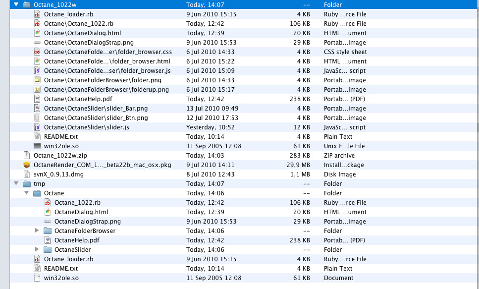

There's something wrong with this zip file, it won't open correctly from the finder on Mac OS X
If i unzip it with the finder, i get one directory with the files all in it, with backslashes in the filenames instead of propper directories. (look in the screenshots attached in the highlighted blue directory, that's what got unzipped. this won't work if you copy it to your plugins directory.
So i used a bash prompt and unzipped your zip file in my home dir in the directory tmp (can see it below on the screenshot) using the unix / command line 'unzip' and then it works fine.
Very strange, and we should investigate why this happens...

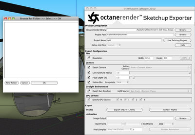

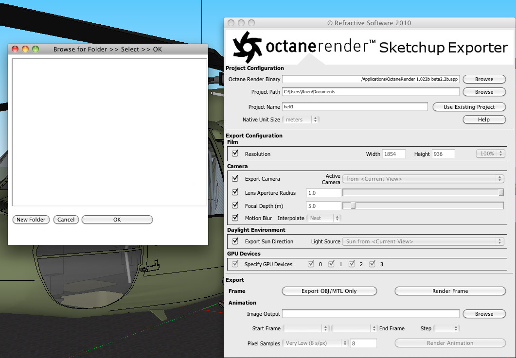

the directory browser you made does'nt seem to work on Mac OS X
i got a testscene from my friend roen and i wanted to change the project path and whatever i do or enter manually in the project path textfield,
if i click on the browse button i get a blank directory chooser that can't be used, so i just enter the path manually in the plugin's textfield to do my test.

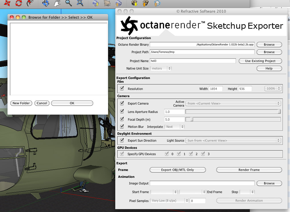

after change manually to my tmp dir in my home, still blank:
all options are on by default
as you can see in the screenshots above, all the options (checkboxes) for the options are all on.
this creates the following launch command:

It was noticed before and should be solved if you unzip with contextmenu and choose unarchiver or stuffit expander. ( readme.txt )
It is known; if you have zipped it on Pc and try opening by doubleclick on the zip file on Mac.

The PC made zip file opening oddly on a Mac was reported by Burkhard the other day - I have changed my PC Zip application relatively recently [was Alzip now its IZarc] BUT this should not have affected it. I've attached two examples one made with Alzip the other with IZarc -
IZarc New Folder.zip
(508 Bytes) Downloaded 403 times
Alzip New Folder.zip
(458 Bytes) Downloaded 415 times
can you test them on a Mac for similarities/variations - perhaps I need to change my zip-app ?
This zip file problem is exactly why I added extra notes into the README / Help for Mac users to right-click > 'uncompress' rather than use the Finder/Drag+Drop versions... Not having Mac access means I can't test this stuff directly...

IZarc does the same wrong folder structure.

Alzip was okay ( Did you not mentioned you changed it to IZarc?)
Wondering if it is program related.

I have recently changed from Alzip to IZarc for making my Zip files - I'll change back as it seems much less prone to such problems when a Mac is used to uncompress a zipped file...
