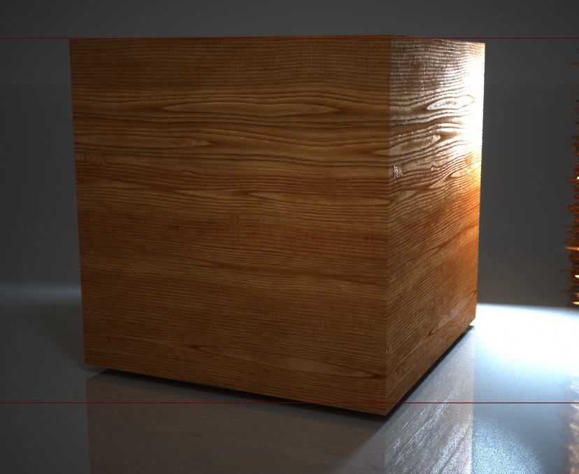

We use substance for Cinema 4D and I didn't even think to test out Substance, but I must say the Material Conversion did a rather good job. So if you don't mind building your Substance then with the plugin importing it into your 3D software and using Octanes conversion, you should be good
