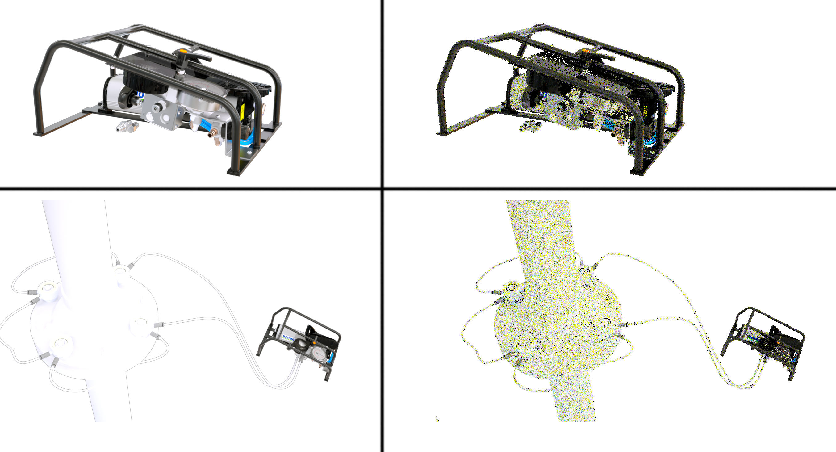

I have tried Octane for an animation but sometimes i get som corruption on some frames. It seems that the frame hasn't been rendered to the max samples i set.
Tried both Direct Light and Path Tracing, with Direct Light i also got a few frames all black.
It mainly occures in the beginning and end of an animation.
I have a few objects set to Movable proxy and have Autoupdate movable proxy set in the kernel settings.
I am using the standard MAX settings and save the files as 24-bit PNG.
Anyone else got this problem?

I have found out what the problem was, i'm guessing it is a bug.
If i have Alpha Channel ticked, this problem will occur (Using a HDRI, with only ambient light it there is no problem).
If i tick Keep environment the problem goes away.
