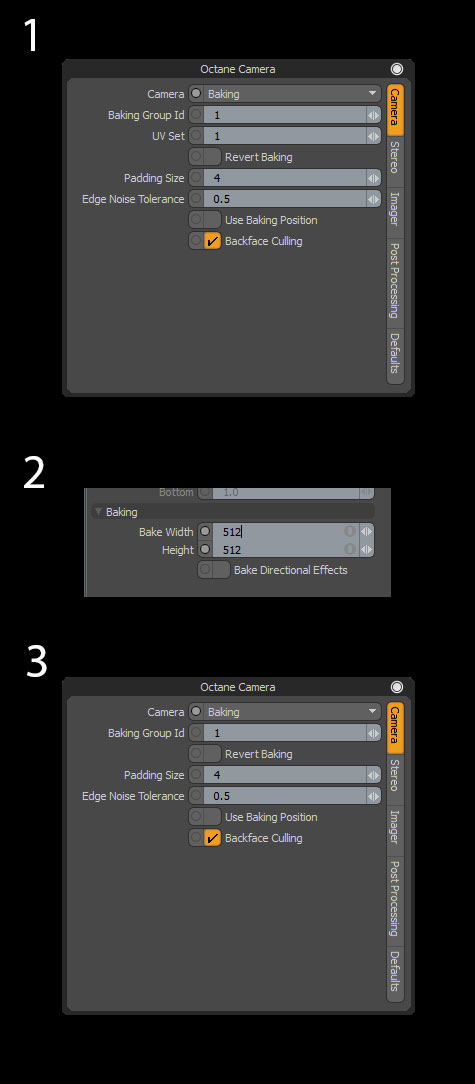

I can't tell where to set the UV set for bake items. Sorry, didn't see it mentioned in the documentation. I like how it is in standalone, with the UV set option right under the bake set id.

It's set in the camera controls.

Weird. My UI does not have that UV selector. I'll try deleting my config and reinstalling.

OK, I found the bug. If anyone else wants to confirm, it is easy to reproduce. Simply go to the Modo render frame tab and change the bake resolution to something else (like 512x512), and when you go bake to the Octane bake camera settings the UV field is now gone.

The UV Set property is being disabled because it is conflicting with the Kernel UV Set property (since they are the same name). So press <esc> to unselect all items, then open the Camera panel to set the UV Set. I will try to find a solution for this.
