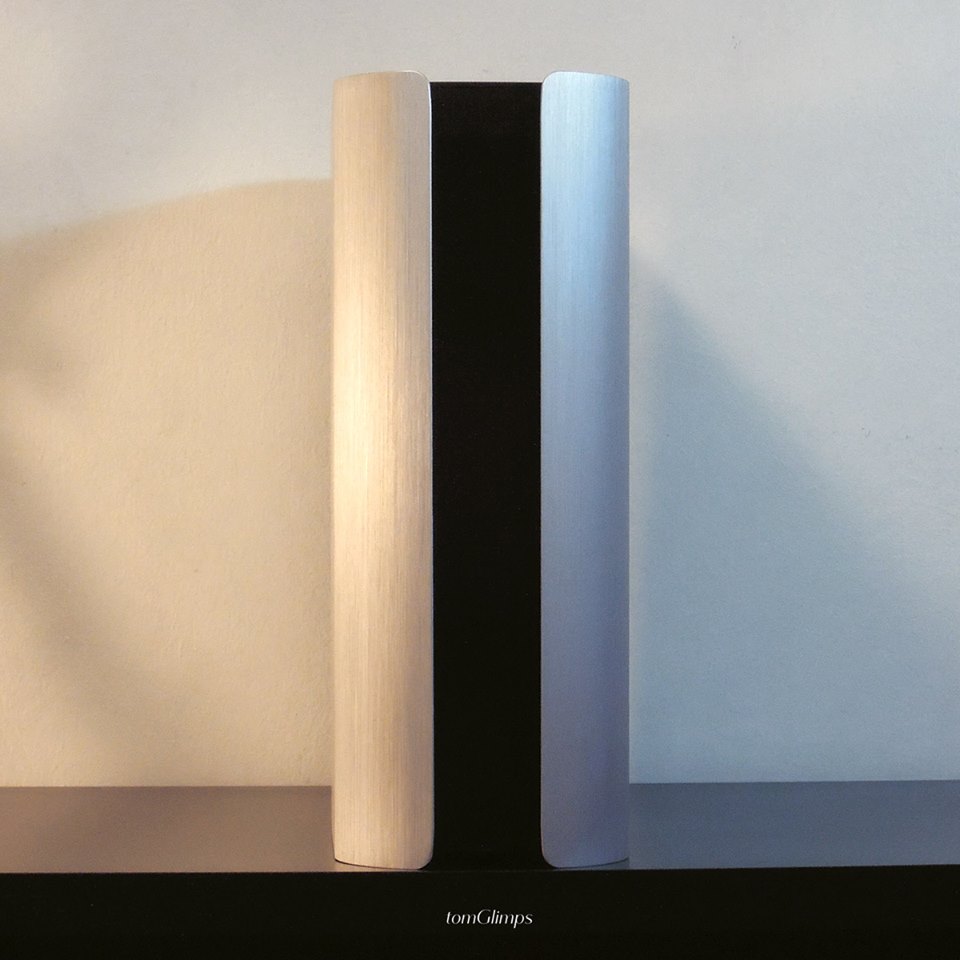

latelly build this one for older MacPro: 4x watercooled 780s 6GB conected via pcie host board.
but it also works with with Thunderbolt powered Macs as well, here it is hooked on MacBookAir.
Akitio was used to house PCIe 1x host board & it works.
more info about the build to come soon..jsut wanted to share as it's somewhat relevant to this topic.
Posts: 10646
Oh Tom, great work ;)
I really would like to have a couple of this, sooner or later :D
Could you approximately share the final cost?
ciao beppe
glimpse
Posts: 3740
bepeg4d wrote:Oh Tom, great work ;)
Thanks, Beppe. The price depends on chosen parts: in this case we had a possibility to get 780 6gb at great price of 320Eu per piece, then cooling cost few hundrets (waterblocks+rads+pump+mount+tube+fitings+fans) few hundred, backplate few hundred, PSU..& case that involved mods.. - not cheap =) but You can fit into 3-4k, I guess.
However if You try to fit all those parts straight "out-of-the-box" - good luck with that! This csutom build involved modifying not only case, rads, but also GPUs & it was build for someOne who wanted simple solution to plug into Mac & run =) wasn't meant to be nor cheap, nor fancy..but rock stable & we've picked some of the best parts for it.
