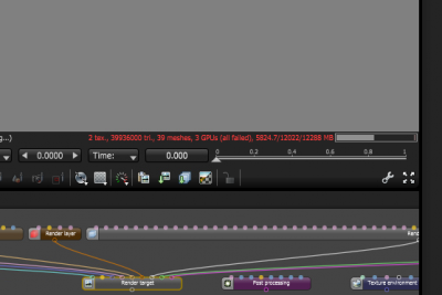

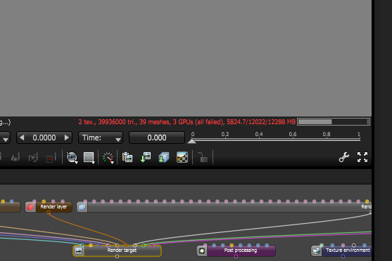

Octane 3.00 alpha4 Import 39.9 M Tri Polygons
Render Failed 5824.7MB/12022MB/12288MB

Octane Log File....
Where is the log file?
Once again the problem of creating a situation I will send a log file.
I did not do something special.
But only it brought in 39.9 million polygons.
And just press the render button.
I wonder if it is my problem or a problem with another person.
It will ever shown symptoms to test the Export Orbx only in Lightwave.

The screen shot was from the Standalone. There you can find the log under Help -> Open log....
