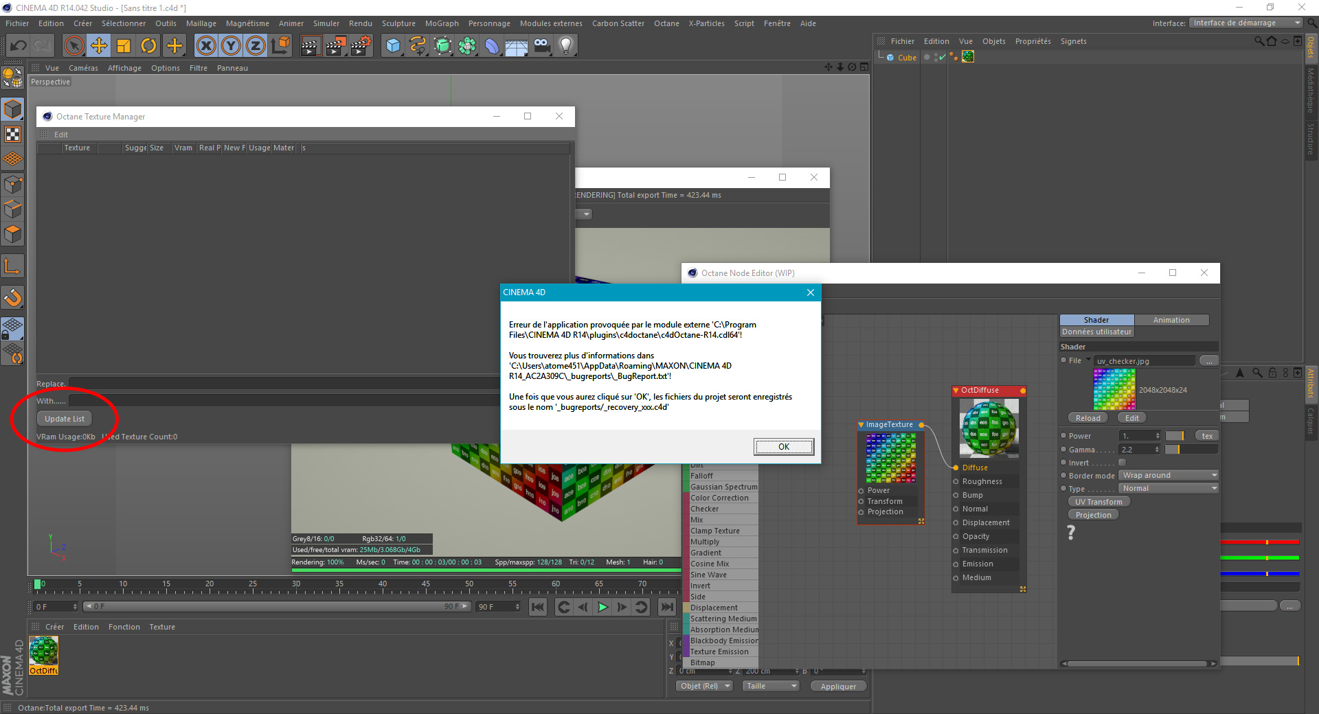

When i call the Octane Texture Manager from plugin menu, on my desktop or my laptop (Windows 10 64b with Cinema 4D R14 in both cases), the wheel appears and turn indefinitively and i have to kill Cinema 4D in the most cases or C4D crashes. Even if i have only one texture used in the project and only one path in preferences without special characters. The hard disk doesn't work more 10 or 15% (simple background processes, nothing for C4D) and the CPU do nothing special... I've tried to wait for 10 minutes before killing the process with no success.
If i have nothing in the project (only one cube and an Octane material applied without any texture), the Octane Texture Manager opens.
- 1/ if i keep the Octane Texture Manager open
2/ load a material and apply it to the cube
3/ load an ImageTexture in Diffuse and a simple jpg from the path in preferences (without special characters)
4/ click on the button "Update list"...
The wheel appears and turn indefinitively (more often) or C4D crashes...
If i keep the Octane Texture Manager closed before loading an ImageTexture, when i load it, the wheel appears and turn indefinitively. With or without the Live viewer running.
I hope these informations will help you.
- _BugReport.zip
- Here is the bugreport after a crash
