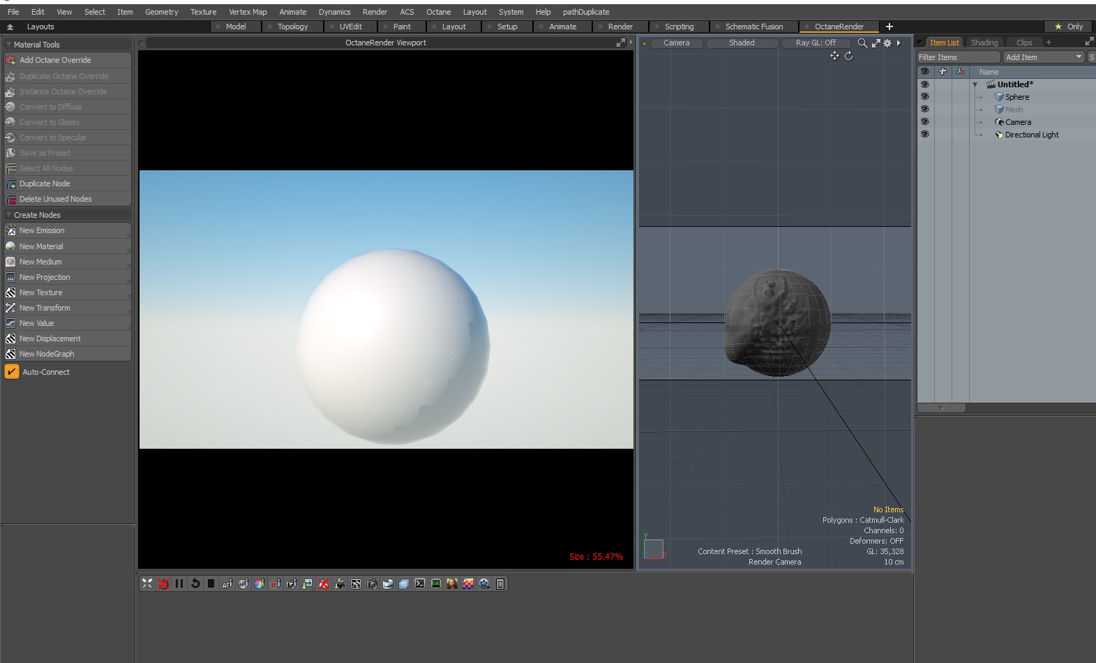

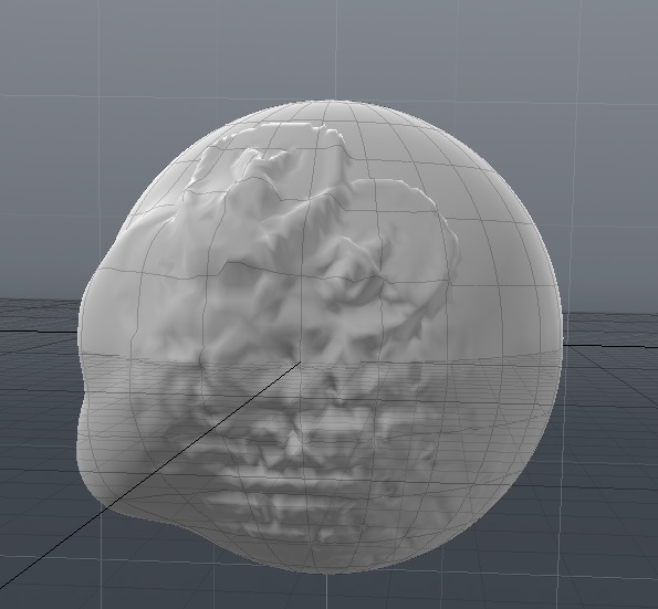

Hi I am using the latest Octane Modo plugin 2_24_2_89 64bit I have this problem with all of my meshes using multiresolution sculpting and sculpt layers I have also had this problem with 901 also I have load cage ticked already but it dosent fix this sorry. Here are two screenshots of a basic sphere with some quick sculpt details it looks fine in the Modo viewport but the polygons look faceted in Octane when I try to render it which is strange

Hi Thanks I got it working now I reopened the file and unchecked load cage then opened it in octane and its working now Thanks again :)
