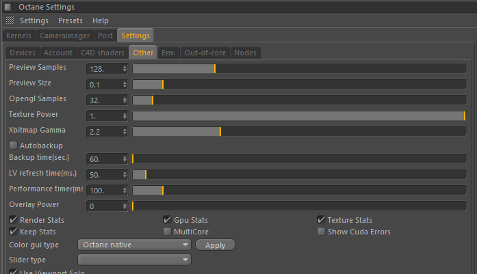

One thing I noticed since I've updated to today's version is that I am missing the render stats within LV even though They're all ticked on. I am running Windows 10 and C4D v17.048.
Maybe its just me?

@dbalzer: It's not just enough to see all stats. Also upper side of LV is a switcher for infos. Click to switch for different modes.
