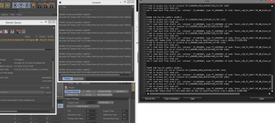

I switched back to 2.24.2 Test6 and did two tests:
Test 1: I rerendered one shot of my project. It got stuck after rendering 10 minutes. The log looks like this. There is no Cuda error in this:
Test 2: I set up a very simple scene with the render settings from Test1. It got stuck after rendering 16 minutes.
The scene file is attached and here is a screen capture of it (Sorry it lasts too long, I sped up the video).
Again no Cuda error. I can't find the reason.

It seems like a random error. Sometimes goes fine. Most likely it's related with render passes. Do you play with any scene on same C4D copy while rendering queue?
