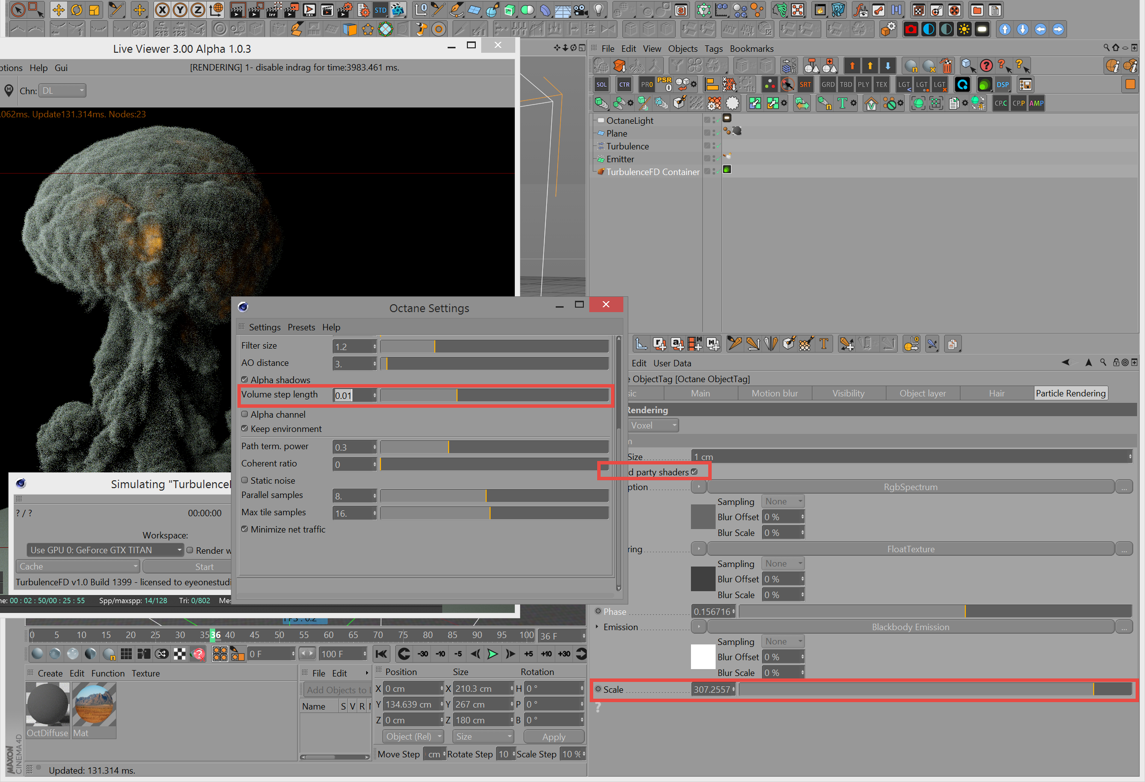

Could you share the Scene?Asym93 wrote:I did a quick test with TFD. I have to say the integration is like magic. The plugin itself is explosive!
Amazing work Aoktar!
Congrats to the Octane dev team!
I want know voxel & tfd setting.
Thanks...
