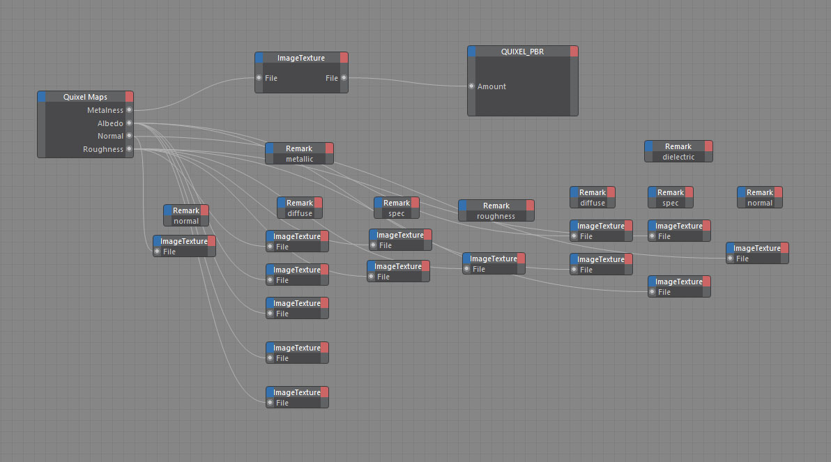

Here's a screen shot of the Xpresso setup.gordonrobb wrote:That looks great. Is there any way you could post a pic of the setup. I'd like to see about creating this in Lightwave.

that makes no sense to meChrisMills wrote:Here's a screen shot of the Xpresso setup.gordonrobb wrote:That looks great. Is there any way you could post a pic of the setup. I'd like to see about creating this in Lightwave.
You have so many Texture Maps. What are they all. Shouldn't you have just 4? Albedo, Gloss, Spec and Normal - or - Albedo, Roughness, Metalness and Normal (depending on which export you're using).

There are 4 Texture Maps, but some are referenced multiple times.gordonrobb wrote:that makes no sense to meChrisMills wrote:Here's a screen shot of the Xpresso setup.gordonrobb wrote:That looks great. Is there any way you could post a pic of the setup. I'd like to see about creating this in Lightwave.thanks anyway.
Here's how I worked out which maps to pipe through to the Image Texture nodes.
-Open up the MBB_QUIXEL_PBR file in Octane Standalone.
-Start with the Mix, Metallic and Dialectic nodes. Follow the links until you find an Image Texture node. Then continue following the links from that Image Texture node until you find the Quixel Map that feeds it.
-Now you have a list of the 4 Quixel Maps and the various Image Texture nodes that need to be linked to those maps.

Yeh sorry, I only asked to see the setup becuase I thought you were writing your own material that was going to be based on a Specular workflow output from Quixel, rather than metalness. No worries.

I'm confused having re-read your post were you showed the helmet. You mention that "the gloss map goes into the roughness input in octane". Metalness workflow does not have a gloss map. That's whey I thought you were using a specular workflow. What maps are you actually using from quixel suite?

I'm using the Metalness workflow - Albedo, Roughness, Metalness and Normal maps. The notes in that post are probably more confusing than helpful.gordonrobb wrote:I'm confused having re-read your post were you showed the helmet. You mention that "the gloss map goes into the roughness input in octane". Metalness workflow does not have a gloss map. That's whey I thought you were using a specular workflow. What maps are you actually using from quixel suite?
The helmet is from a sample file in the Quixel manual. It has a mesh and pre-made maps. The helmet maps aren't using the Metalness workflow.
The Quixel 2 pre-set for Octane is outputting maps in the Metalness workflow.
