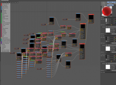

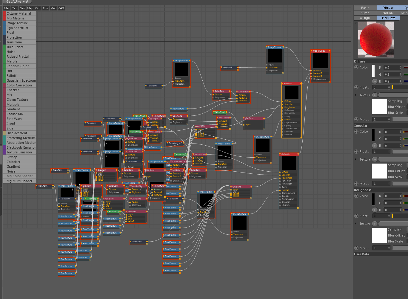

I thought i would try the technique inside c4d - Everything went well & i found the 'MBB_QUIXEL_PBR' material in the liveDB (it's under misc) but the material is super complex to manage (screenshot attached), And it doesn't easy "plug&play" like the standalone.
If i had some time i would make some user data for the material and upload it here but i'm pretty busy for that :/ So if anyone tried it and got some elegant solution that would be sweet.

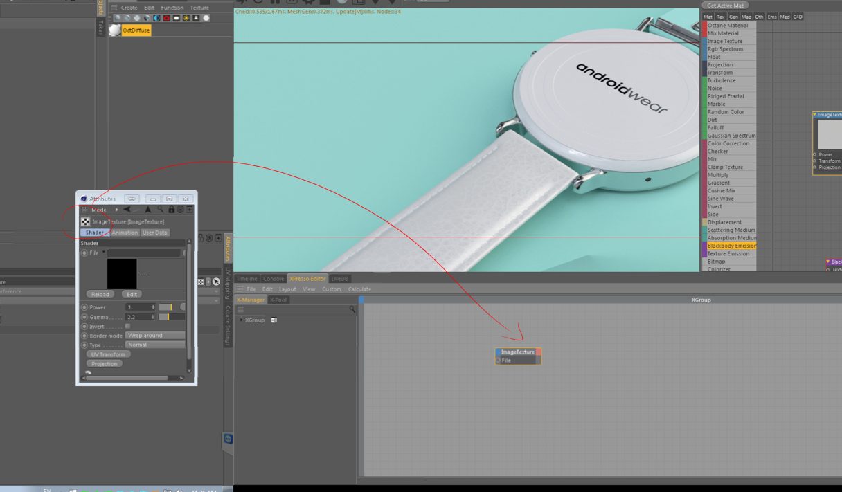

Using just User Data and Xpresso, I can't find a way to access the texture path within the Image Texture node. If anyone knows how to do that I could probably sort out the piping of the User Data into the various Image Texture Nodes.
I'm itching to get some kind of solution sorted out. The Quixel 2 PBR textures look amazing...as does the "freelancer" price tag.
Just grab this icon from the desired image texture to xpresso, and the file will available as an input.

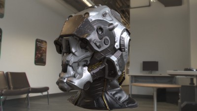

I've got an Xpresso setup done, but I'll need to go over it carefully to make sure everything is working correctly. I've attached the C4D file.
The image is rendered in Octane C4D using the sample file from the Quixel manual.
If anyone wants to try it out:
-Click the "Quixel Maps" null and select the "User Data" tab. Fill the four texture slots with the Quixel generated maps.
Note: The "Gloss" map from Quixel goes in the "Roughness" slot. The "Specular" map from Quixel goes in the "Metalness" slot.

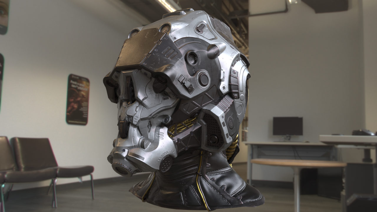

Hi guys,
I'm a total noob in texturing and shading, I don't know what to do and how to do it, but I think the specular/metalness map in octane plugin for cinema is inverted by default.
Here's quick test of a random shape rendered in quixel:
Then imported in octane plugin (different hdri enviroment and illumination, I know):
If I invert the specular map in photoshop I get this result in c4d:
Same thing if I export an .orbx from Octane standalone and import in cinema, the map is always inverted.
Is it just me?
