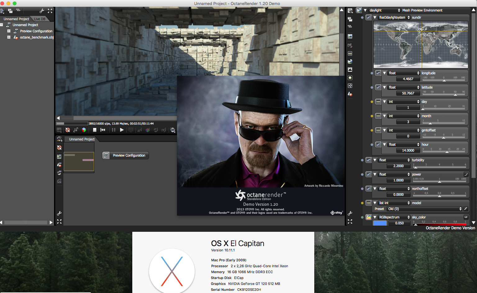

no problem here with OsX 10.11.1 and Octane 1.20:
What is your hw configuration?
Have you installed the CUDA drivers?
ciao beppe

Hi it worked after I installed the latest CUDA driver, thanks for your help :P
