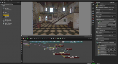

Samples are coming now that app updates correctly. We are building the authoring into Octane via script nodes, and it will export lua/JSON, publish to ORC for you. Once that is done we can finalize the documentation.
It is maybe 60% there:
