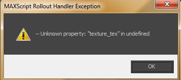

when i try to start octane_shortcuts, i get this error:
unknown property "texture_tex" in unindifined.
does anyone know how to fix this?

Jorgensen :
That is simply because you run the the script with an older scene made with 1.9 or prior versions.Jorgensen wrote:when i try to start octane_shortcuts, i get this error:
The environment map in the old files tend to work differently now, due to the changes in the plugin by jimstar.
So what you can do is to copy current environment map to another material editor balls. Make a copy of that
and clear the current Environment Map. By right clicking and press Clear.
Then run the script.
