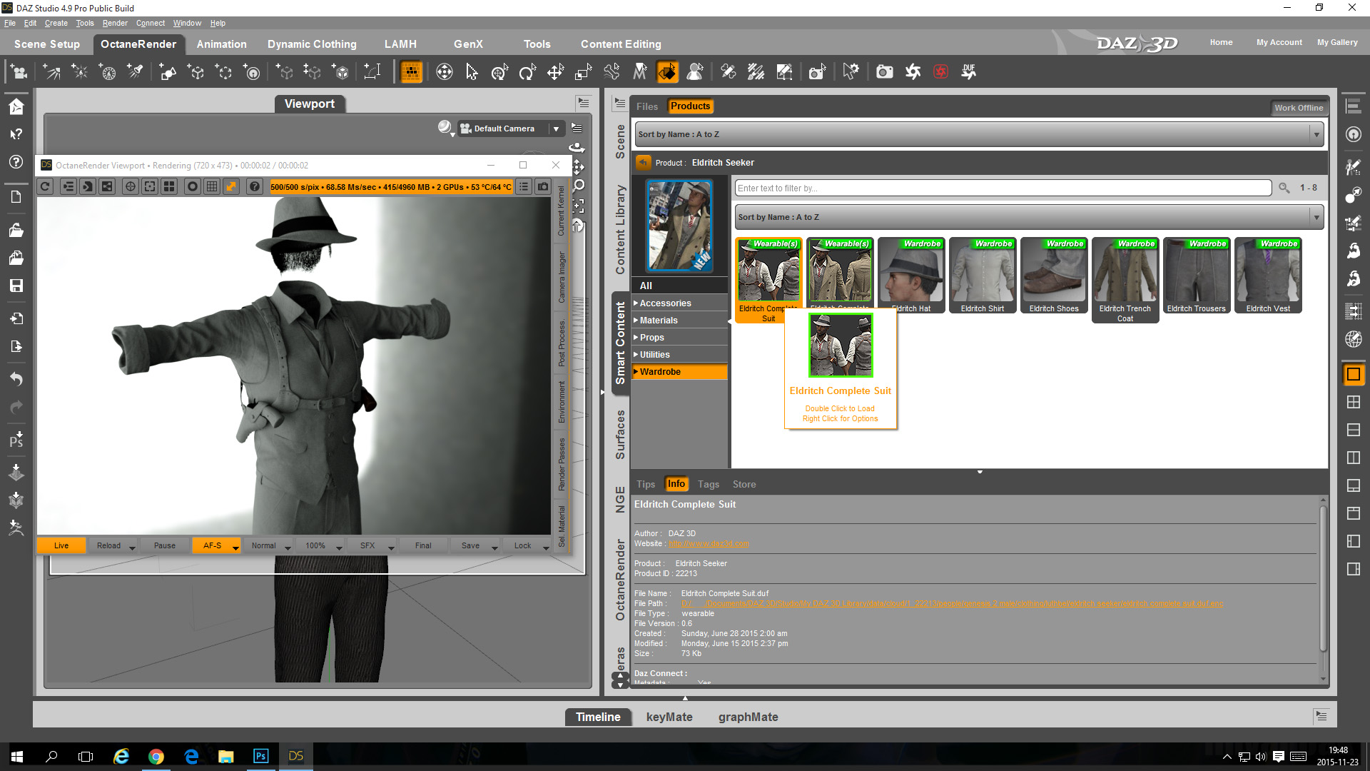

Saving wearable(s) with OctaneRender materials included - not yet tested
In this example you can see several presets for "wearable(s)" that load both the geometry and the material information.
Things to test:
In DAZ Studio select
File/Save as/Wearable(s)
Check if OctaneRender materials are included.
Each time you click on a preset a complete new set of geometry is added to the scene and with it the default materials.
This also means it will take time to load the presets because the geometry is included.

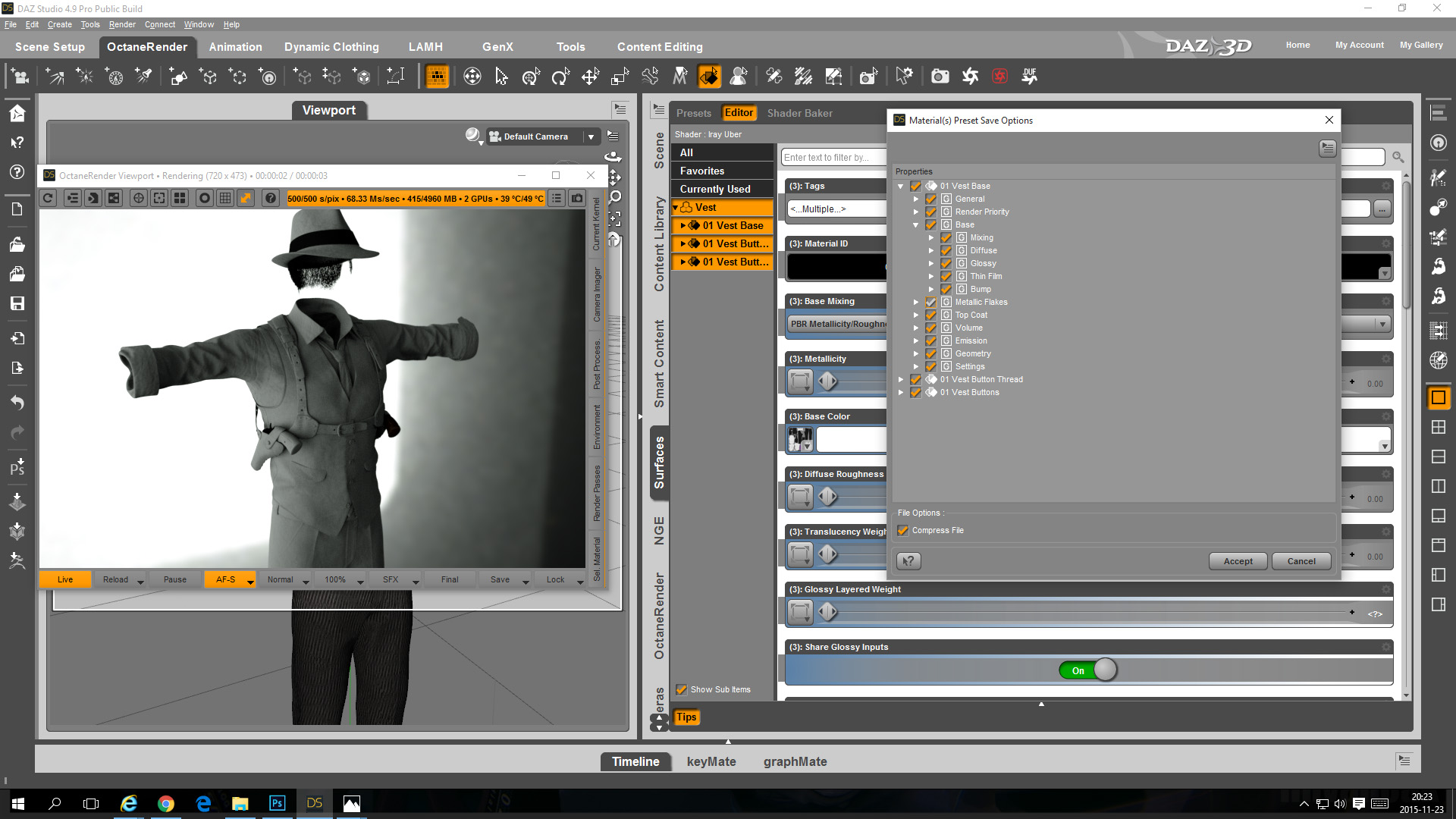

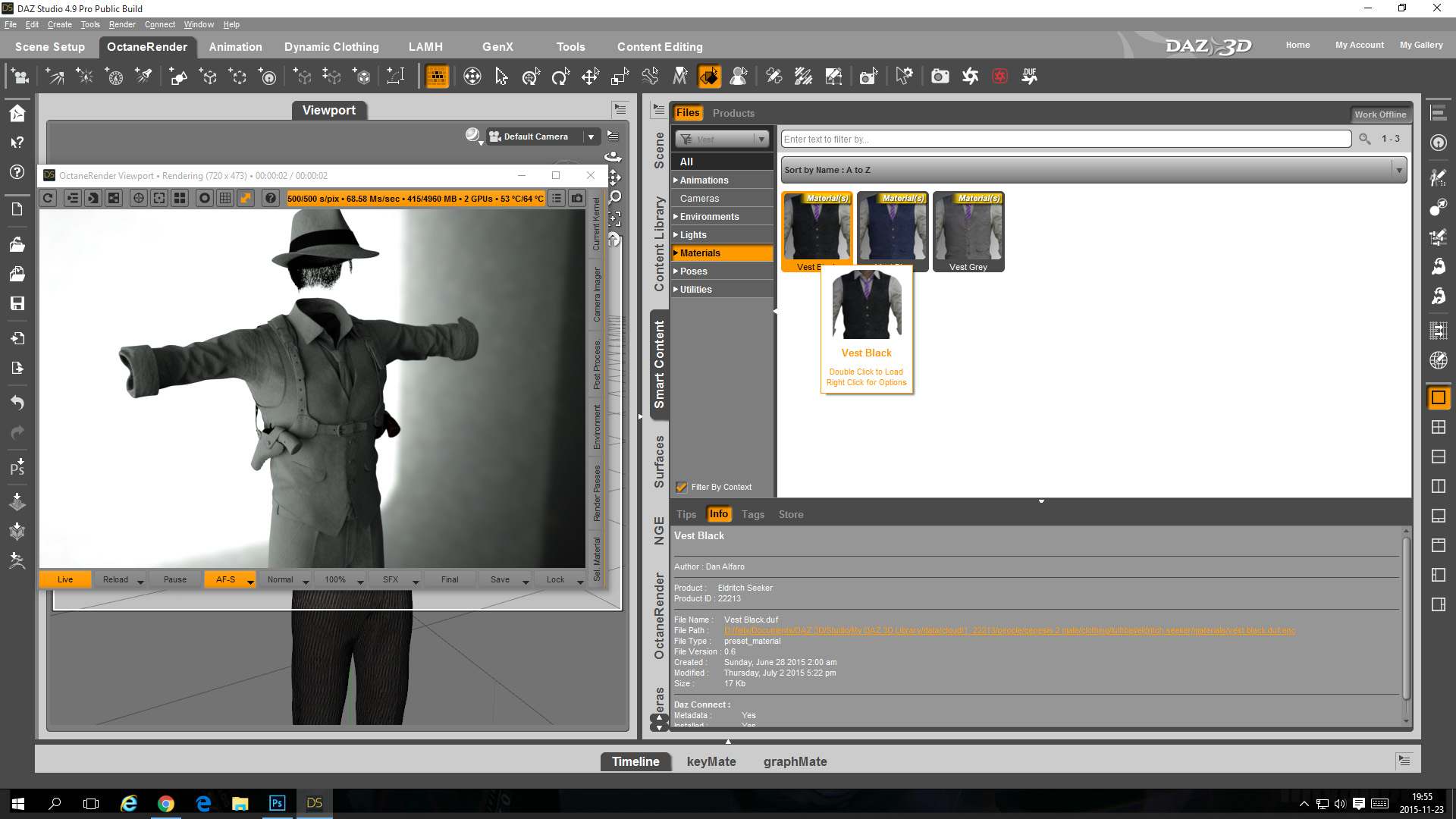

What is the benefit of Material Presets compared to saving as a complete scene, wearable, actor or prop?
When you select an object in the scene in the smart content tab you can see all material presets that are compatible with the selected object.
In this example the vest was selected in the scene and all the color options for the vest are displayed.
When you click on the materials preset only the materials are reloaded. Because the geometry is not loaded the process to change materials is very quickly.
In addition with the help of material presets it is also possible to just load new material options for one surface zone while leaving all the other surface zones of the selected object unchanged.

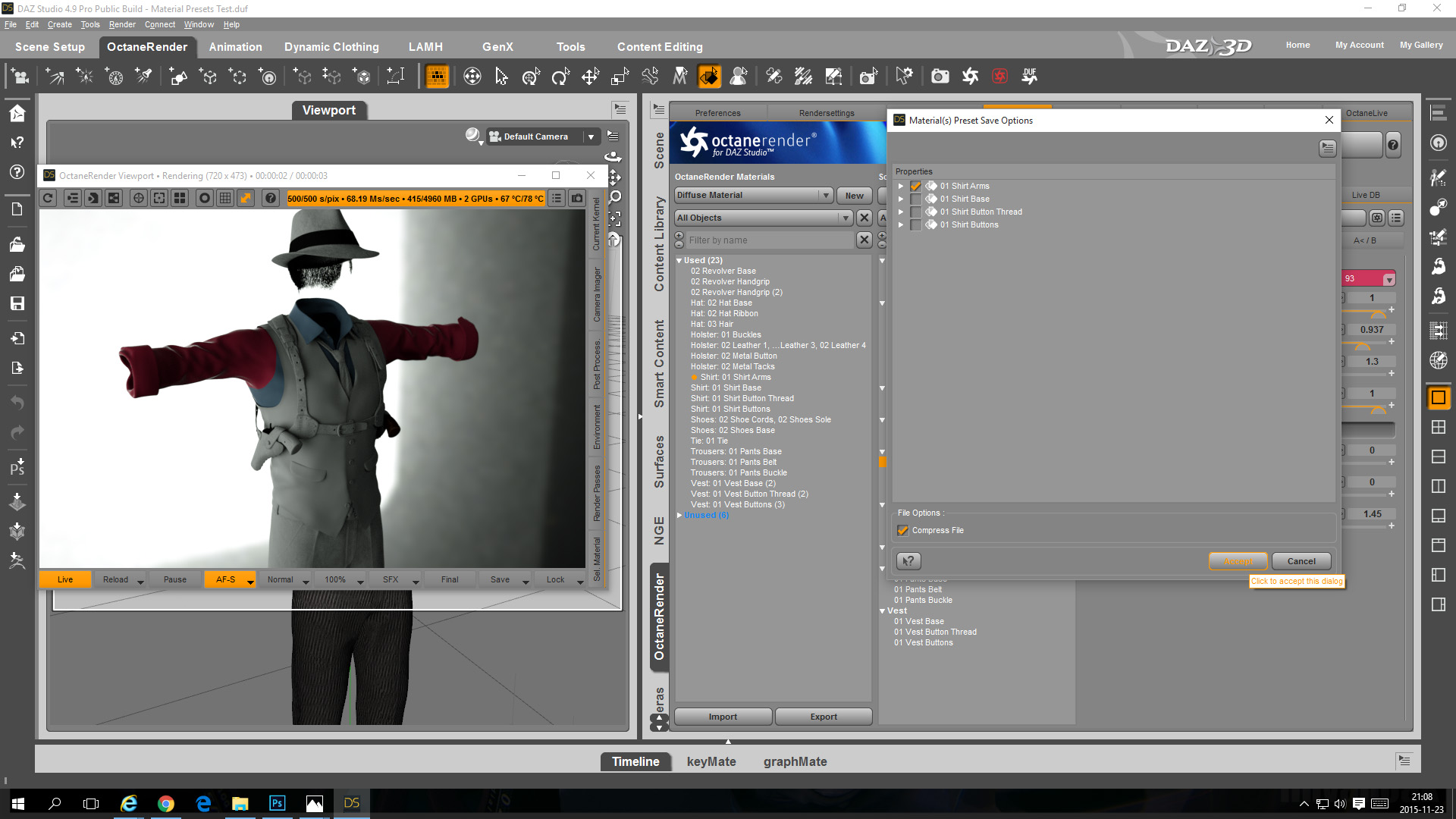

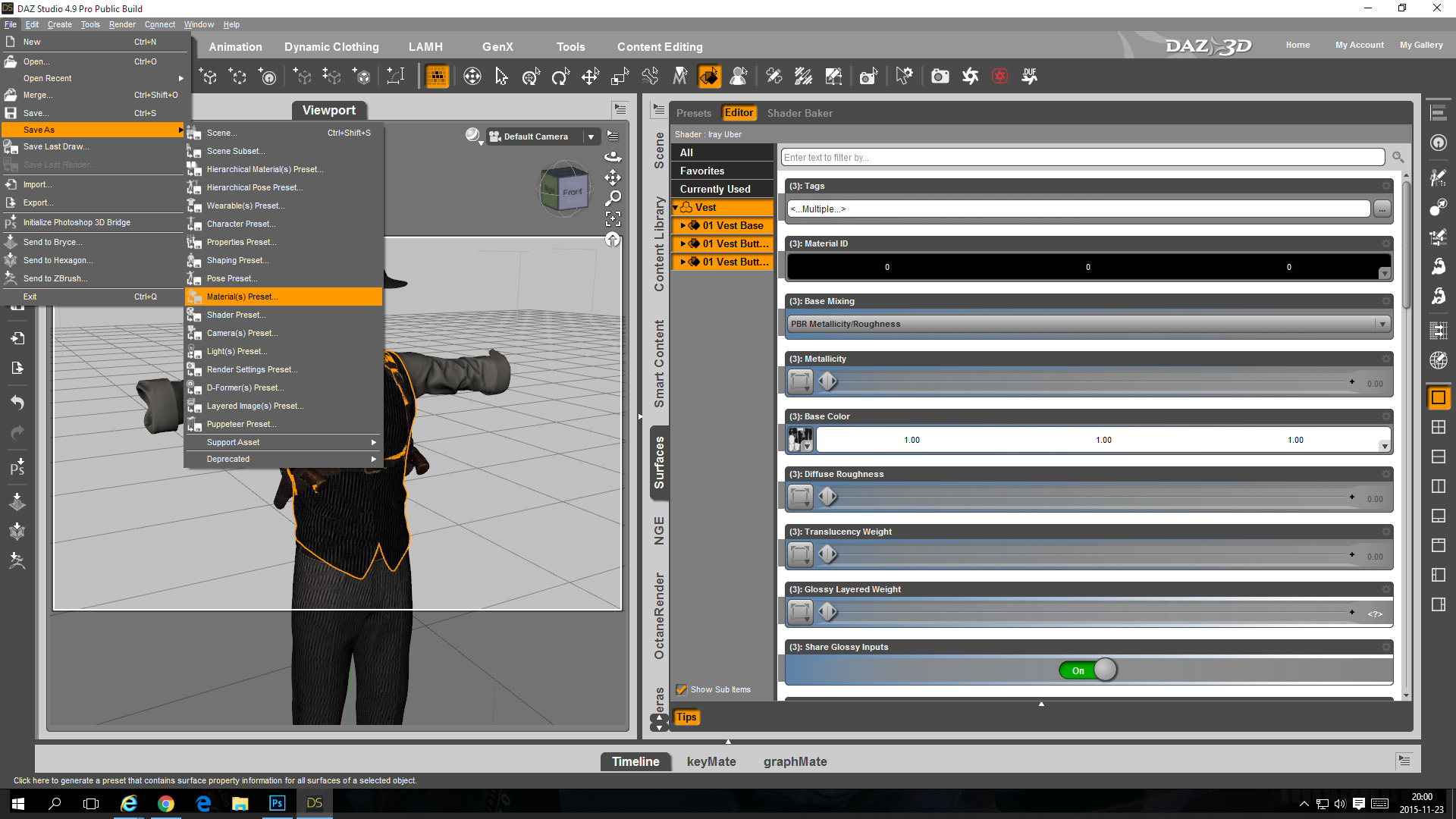

How are Material Presets created that include OctaneRender material information?
- Select the object in the scene
- In DAZ Studio select
File/Save as/Material(s)
- In a pop up window you can now select which specific 3Delight or Iray nodes or surface zones should be included in the material preset.
3Delight and Iray are both integrated directly into the DAZ Studio surfaces tab.
This direct integration with the DAZ Studio surface tab seems to make it possible that in the save dialogue for the material presets you can choose individual surfaces and even nodes that should be included.
Because OctaneRender is not integrated directly into the DAZ Studio surface tab it seems not possible to select individual nodes to be included or omitted in the material presets.
BUT
You can select the surface zones for which OctaneRender materials should be included.

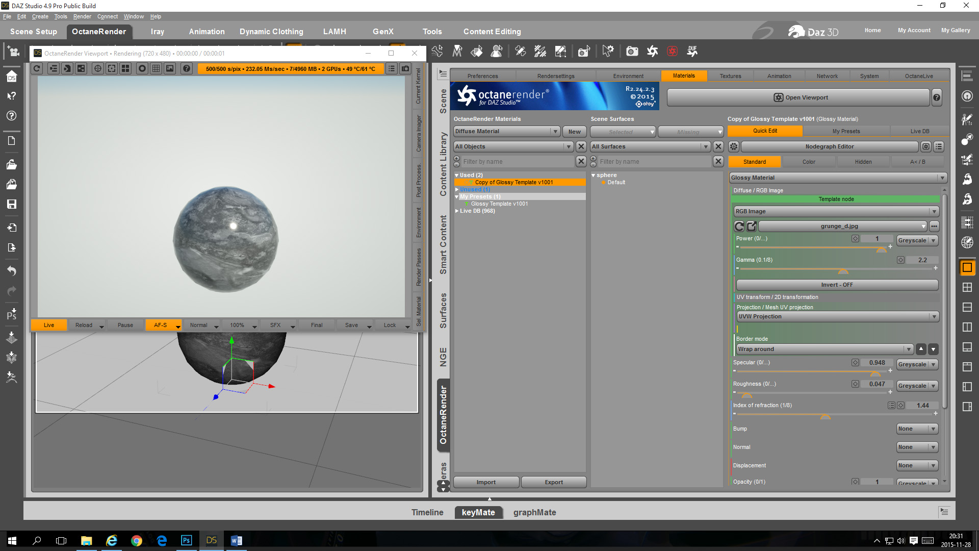

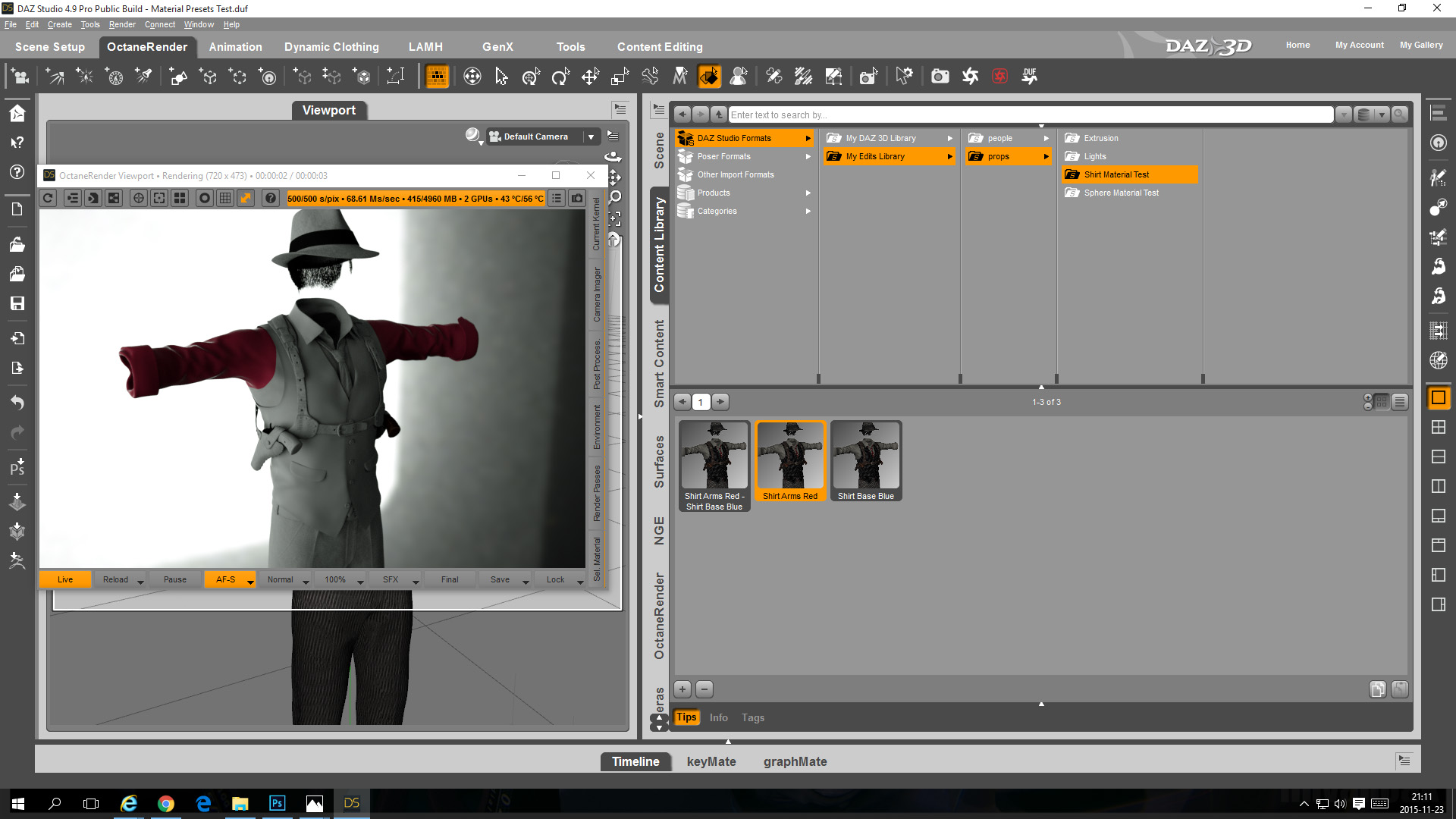

In this example I created a simple diffuse material directly inside the OctaneRender materials tab.
This means the original surface in 3Delight or Iray OpenGL viewport is still a default color.
Because we only want to create material presets for OctaneRender we do not need to worry about that for now.
The shirt arm is red.
The shirt base is blue.
If you want to save all OctaneRender materials for all surface zones of an object all you have to do is click on accept in the material preset options.
If you just want to save a material preset for one surface zone select the surface zone you want and uncheck the others.
In this example we only want the red shirt arms:
I also created a material preset for just the blue shirt base.

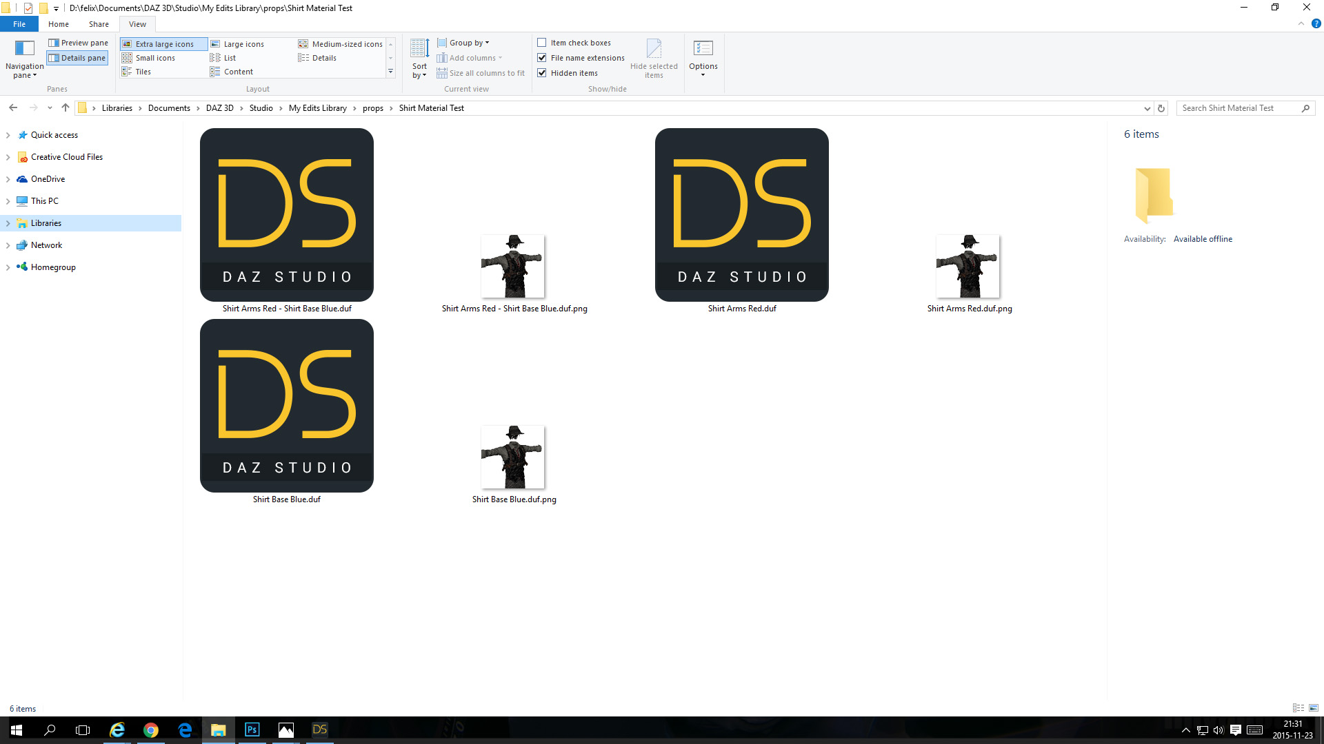

- In the save location you choose you will find the material presets as .duf file and also an preview image that was automatically generated based on the OpenGL color of the shirt.
Note that in the preview image the color of the shirt is still default because in the OpenGL viewport OctaneRender material changes do not show up.
Nevertheless it will only take a few minutes to manually create a preview image based on a product render so nothing to worry about.
- If needed you can also manually move the .duf file and the preview image to another location in your DAZ Studio library.

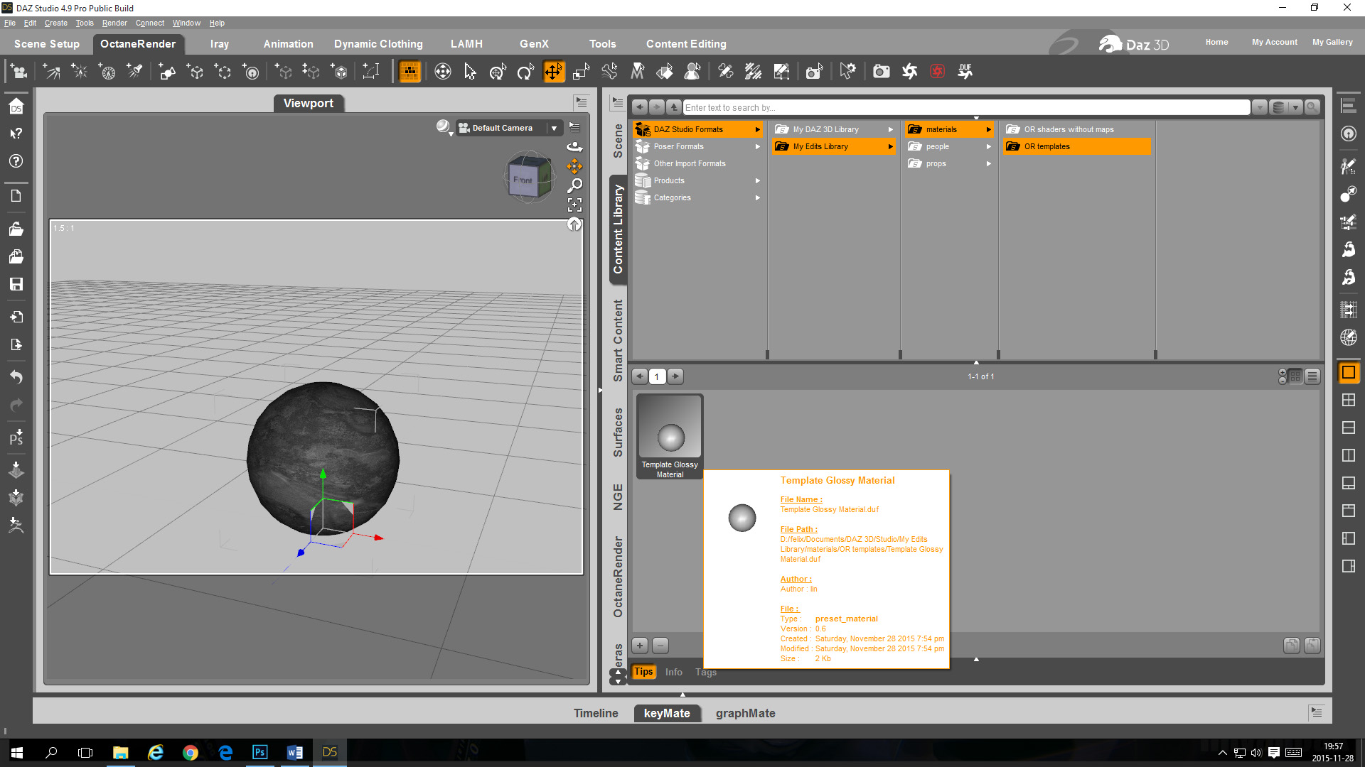

In this example the material presets show up in my personal library for my edits.
All you have to do now is to click on the material preset and the OctaneRender viewport is updated a second later.
This means all the OctaneRender surface zones in the OctaneRender materials tab are updated automatically with the click of just one button.
There is no more need to tediously drag around material presets saved inside the OcDS materials tab over to the OcDS surface zones.

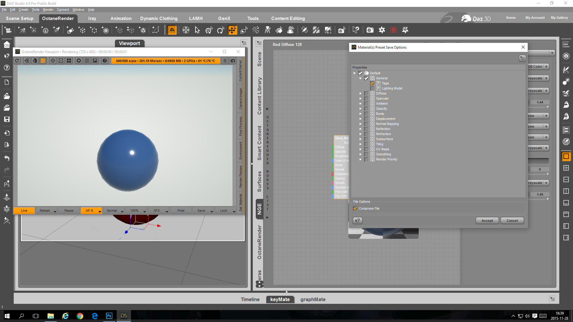

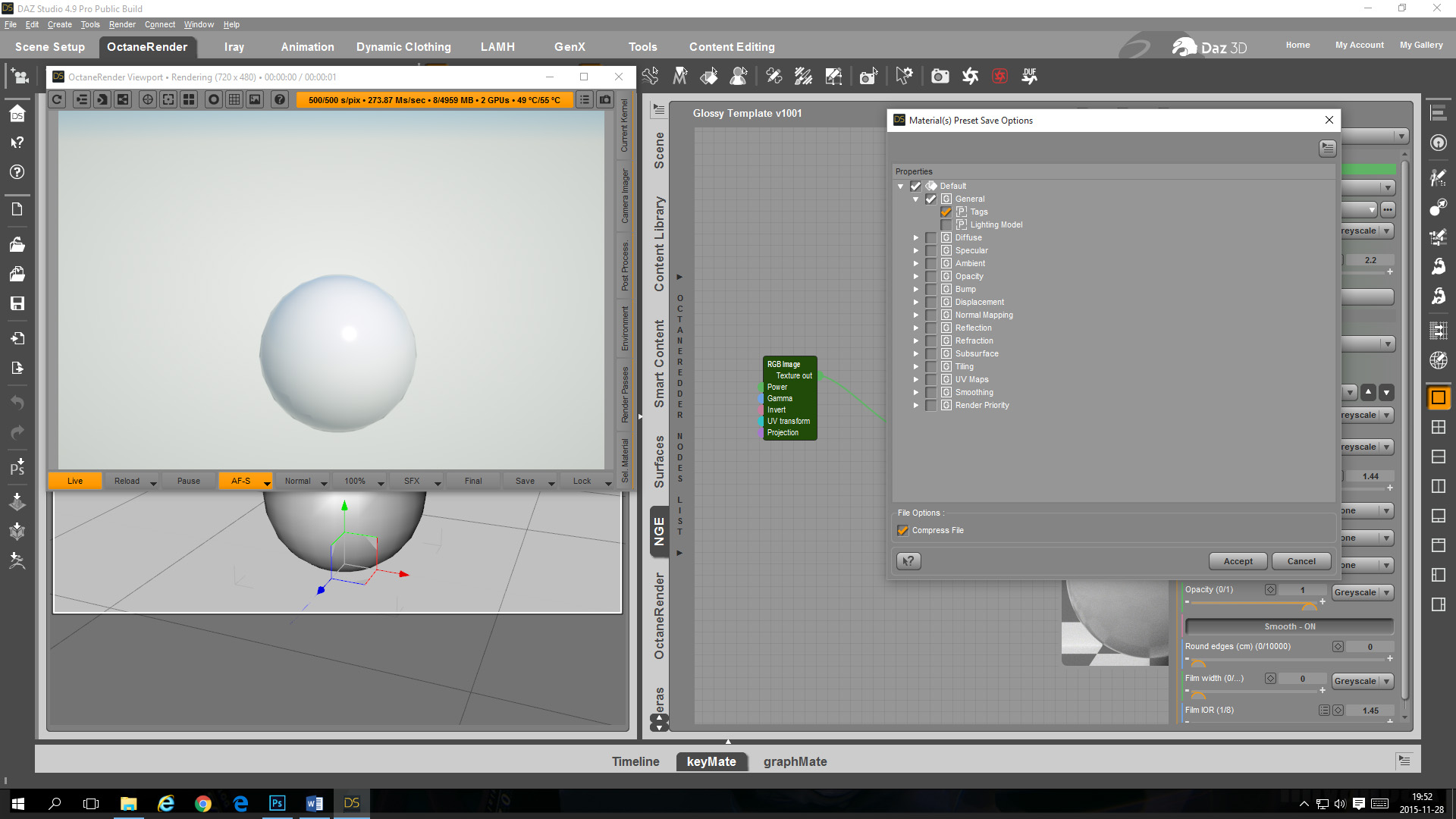

How do I save DAZ Studio material presets with OR Materials that do NOT include Iray or 3Delight materials?
As we have seen in the first tutorials Iray or 3Delight materials applied to the selected surface zones will by default be included when saving DAZ Studio material presets. Remember that automatically all the OctaneRender materials are included for the selected surface zones.
If we do not want to save any Iray or 3Delight materials along we have to uncheck any Iray or 3Delight specific nodes but the in the material save options.
Nevertheless in order to still have a surface zone selected the "tags" node still needs to be carried over.
A step by step guide to understand the workflow:

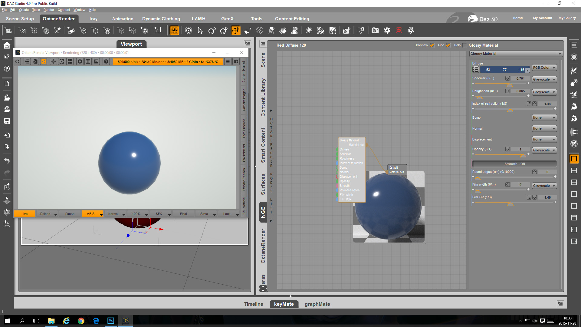

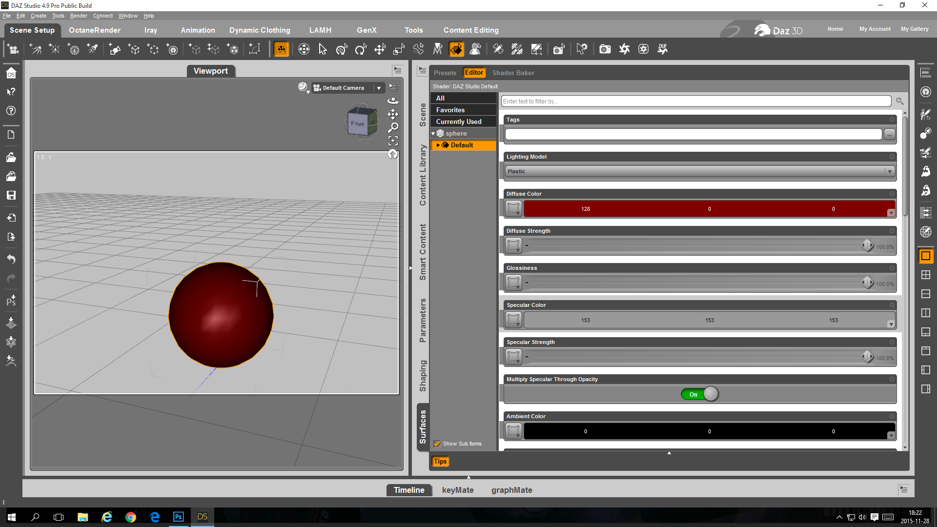

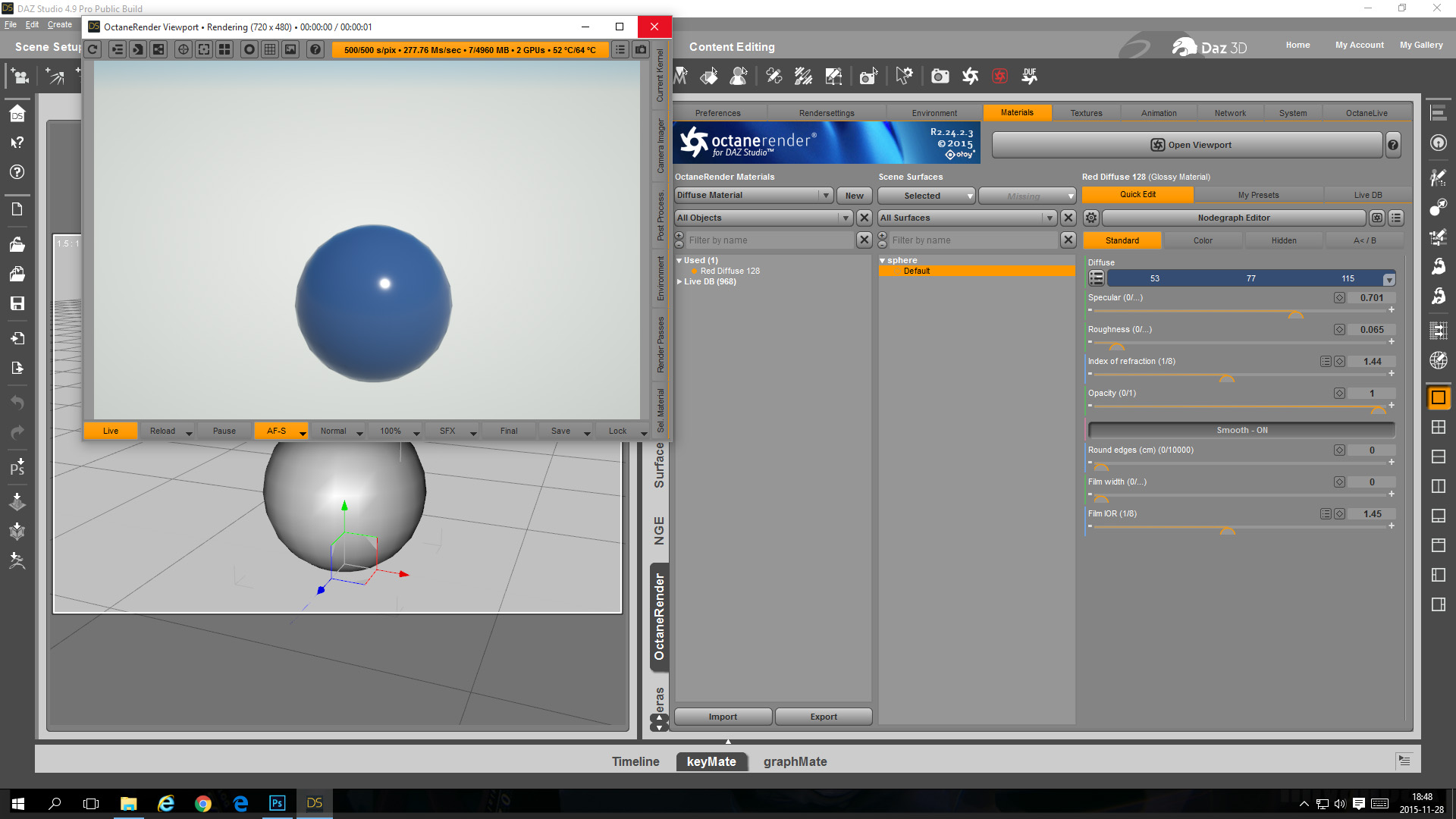

- Place a sphere in the scene
- In the DAZ Studio surface tab switch the diffuse color of the sphere to red
- Use the material auto conversion or create a blank material for the sphere

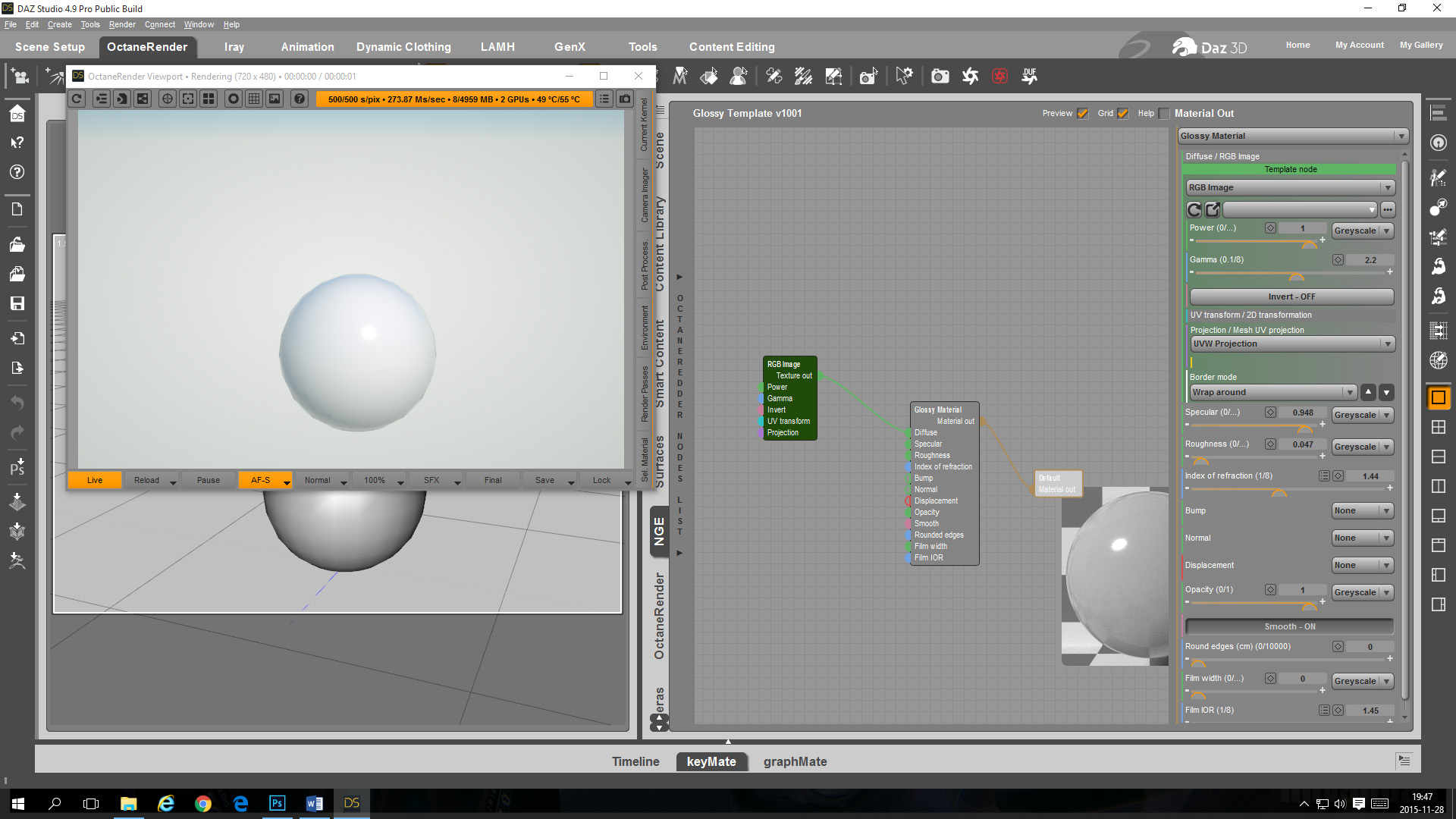

- In the OcDS Node Graph Editor change the sphere material to a blue glossy material
- In DAZ Studio select File / Save as / Material Preset
- In the DAZ Studio Material Preset save Option remove the checkmark of each entry and only keep the "Tags" option under "General" of the surface zones you want selected
If you would remove all check marks of all entries under a surface zone the surface zone itself would be deselected and the OR materials for that surface zone would NOT be included.
Therefore the idea is to keep one setting of the surface zone selected that will not have an effect on the existing Iray or 3Delight surface zones when applying the OctaneRender material preset later.
The "Tags" option under General simply included keywords that describe the surface zone and is often not used at all. Therefore it serves as a good place holder to keep the surface zone selected.
- An DAZ Studio Material Preset .duf file and a OpenGL preview image was created in your selected save location

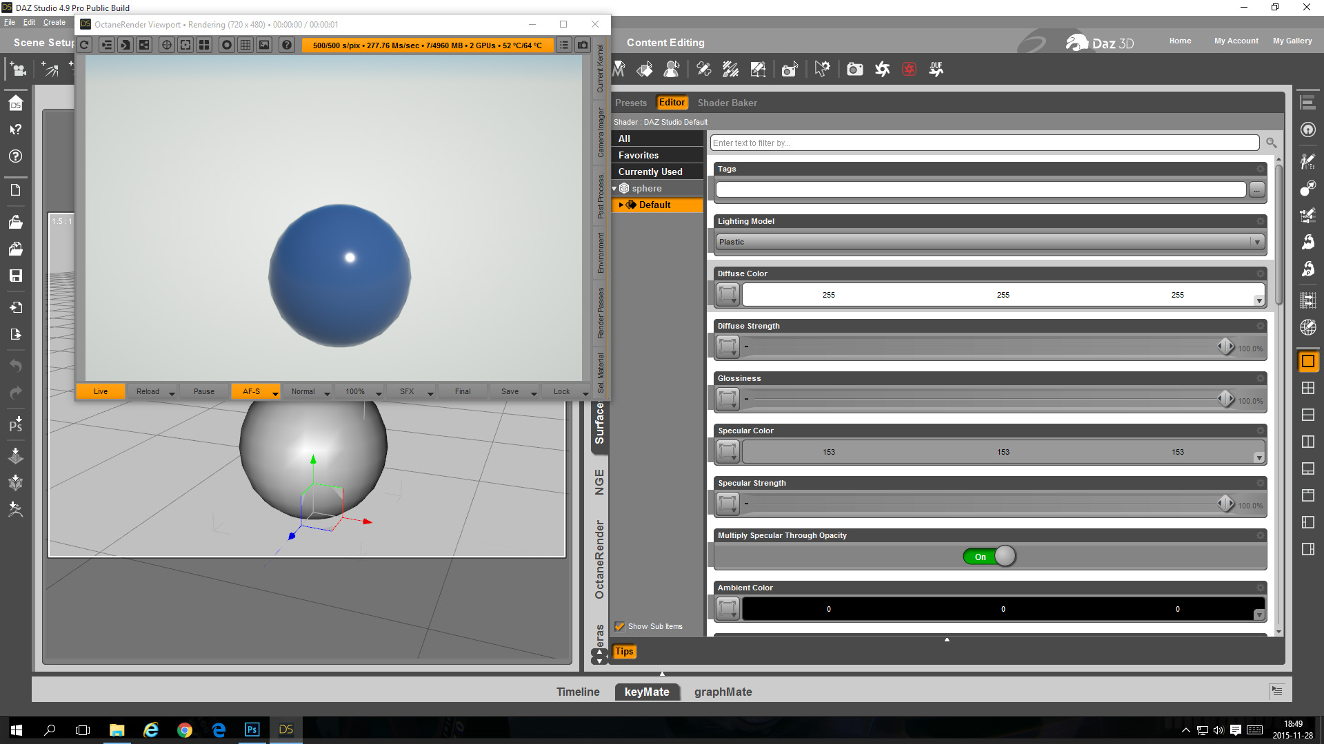

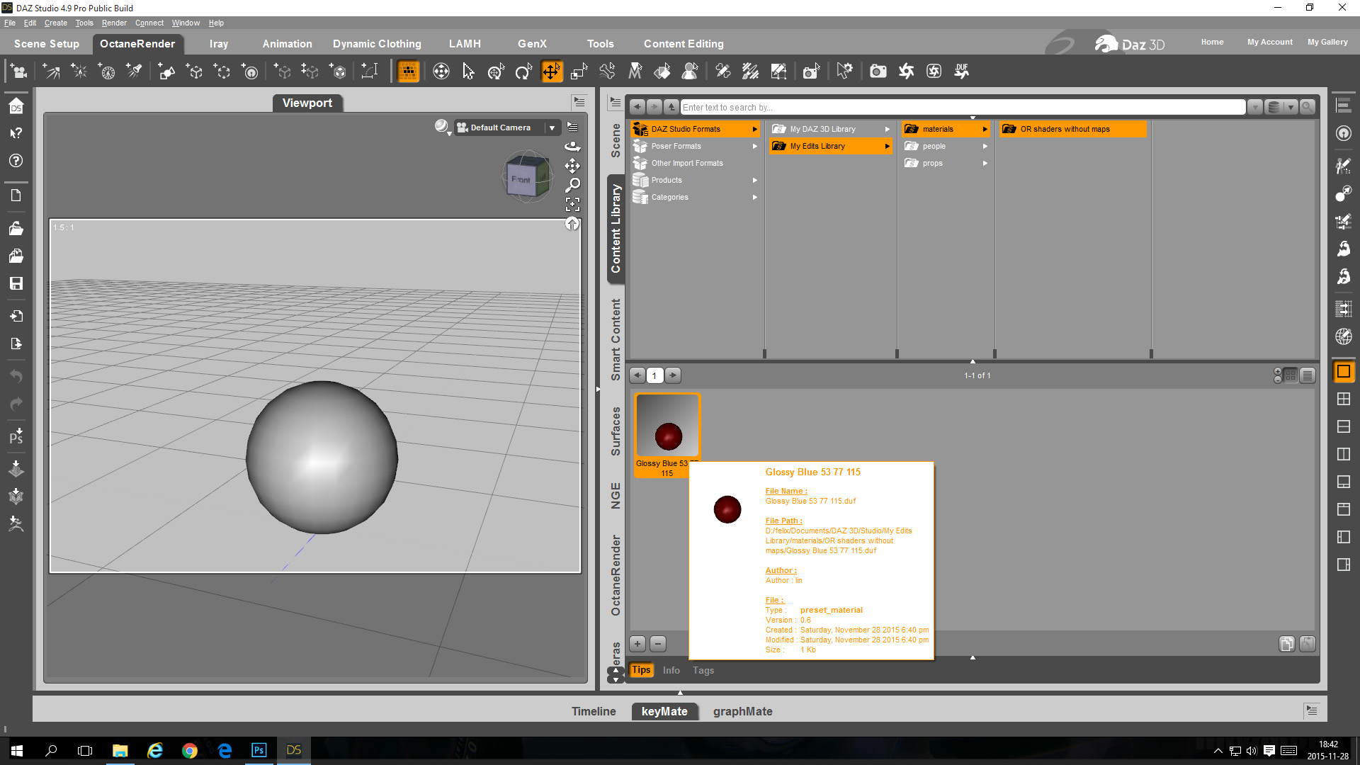

To test your new OR material preset perform the following steps:
- Create a new scene
- Select the sphere surface with the surface selection tool
- Apply your OctaneRender Material preset
Note: The OpenGL preview image of the OR Material Preset shows a red sphere because the color of the 3Delight material of the sphere was red when saving! Even though the red 3Delight Diffuse material settings were not saved a screenshot of the OpenGL viewport was still saved along. Just create a new preview image based on one of your product renders.
Now you can check the results:
- Open the OR viewport
Your blue Glossy OctaneRender material is applied to the sphere. None of the existing DAZ Studio surface zones were changed.
What is the benefit if saving OctaneRender material presets that do not include Iray or 3Delight materials?
Now you may still wonder
Why would anyone want to create OctaneRender material presets that do not change the existing Iray or 3Delight materials in the scene?
In general someone may want to only include the material information that is needed without having any possible unwanted side effects later.

Templates!
In theory if you want to save OctaneRender material template as DAZ Studio material preset you want to make sure that the saved template does NOT overwrite any existing 3Delight or Iray materials in the scene.
The theoretical workflow is:
- place a figure with a 3Delight or Iray material in the scene
- run OcDS Material auto conversion
- apply the template Material to convert the auto conversion to a new material that includes all the maps but uses template values for the OR nodes
- optional: if you do not like the result apply another template
If Iray or 3Delight materials would be included together with the template material preset they would overwrite any existing Iray or 3Delight materials in the scene. Then you would have to reapply the 3Delight or Iray material presets before you can try out another template again.
In practice the issue is that when applying the DAZ Studio material preset the templates are overwriting already existing maps applied to the OcDS surface zones.

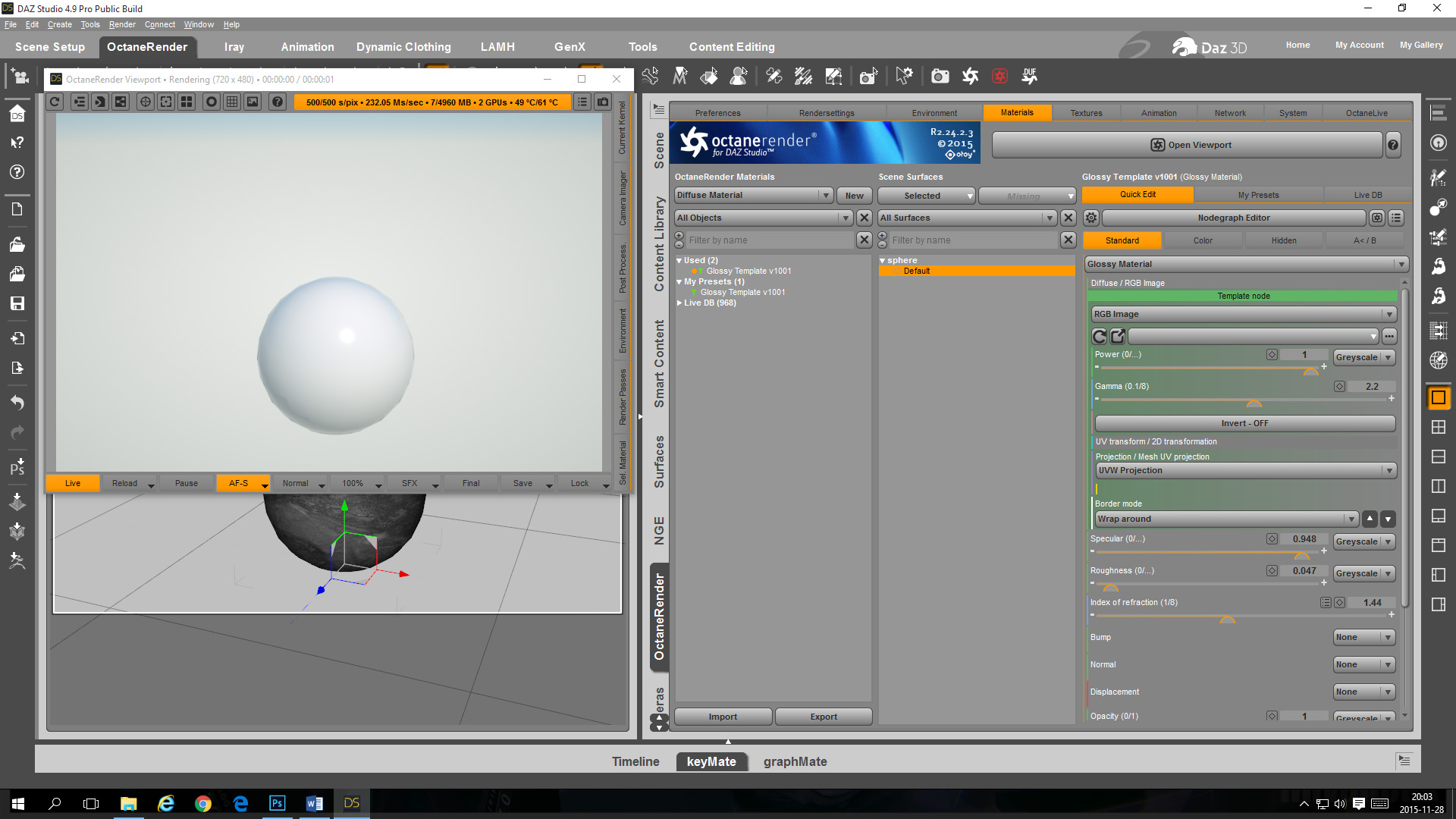

A step by step workflow to follow:
- Create your own Glossy Material Template in the OcDS Node Graph Editor with a template for a diffuse map
Make sure to use some unique Specular, Roughness and Index of Refraction settings.
- Save as Material Preset and select only the "tags" on the surface zone you want
- Create a new scene with a new sphere
- apply any diffuse map to the sphere
In this example I use a map from the "Default Lights and Shaders" product
- Use the OcDS Material Autoconversion
- Make sure to select the sphere surface with the surface selection tool
- Apply the DAZ Studio material preset of the OR template material

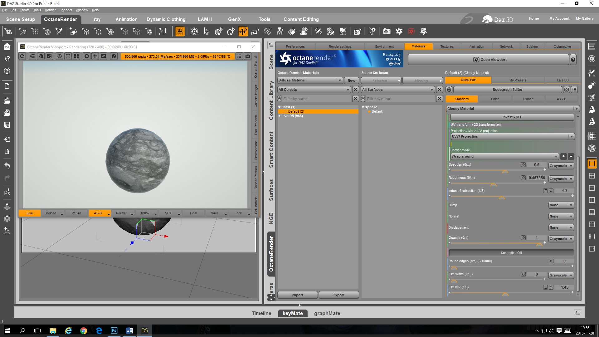

Now you can see the issue happening:
- When applying DAZ Studio Material presets the template material is applied but the original maps already present are overwritten in the OcDS materials tab
What does this mean in practice?
The whole purpose of a template material is to apply a specific set of values to an existing OR material while keeping all the maps already applied to the previous material in the OcDS material tab.
Inside OcDS templates are applied by dragging them over from the OcDS "User Presets" to an existing surface zone with an OR material applied.
In this example you can see how the original maps of the previous material are kept but the template materials values are applied:
When applying templates what is supposed to happen in the OcDS material tab is:
Change the values - keep the maps
Nevertheless if you follow the workflow above and apply OR templates saved as DAZ Studio material preset the following happens:
Change the values - maps are not kept
Update / Edit:
Thanks to abayliss there is a simple workaround:
- select the surfaces with the template nodes applied
- right click and select "Replace all active maps"
You will find some screenshots and another example workflow in a later post of this thread
