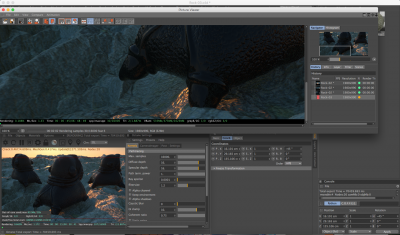

I have a set up similar to yours and I use the out-of-core feature every day. It save me because currently I have only a GTX 560 1GB on my mac. Here is an example (apologize for the messy scene just for testing purpose) with 4x 8k textures and 1.8 m polys:
I expect that you can manage more bigger scene with yours set up :roll:
