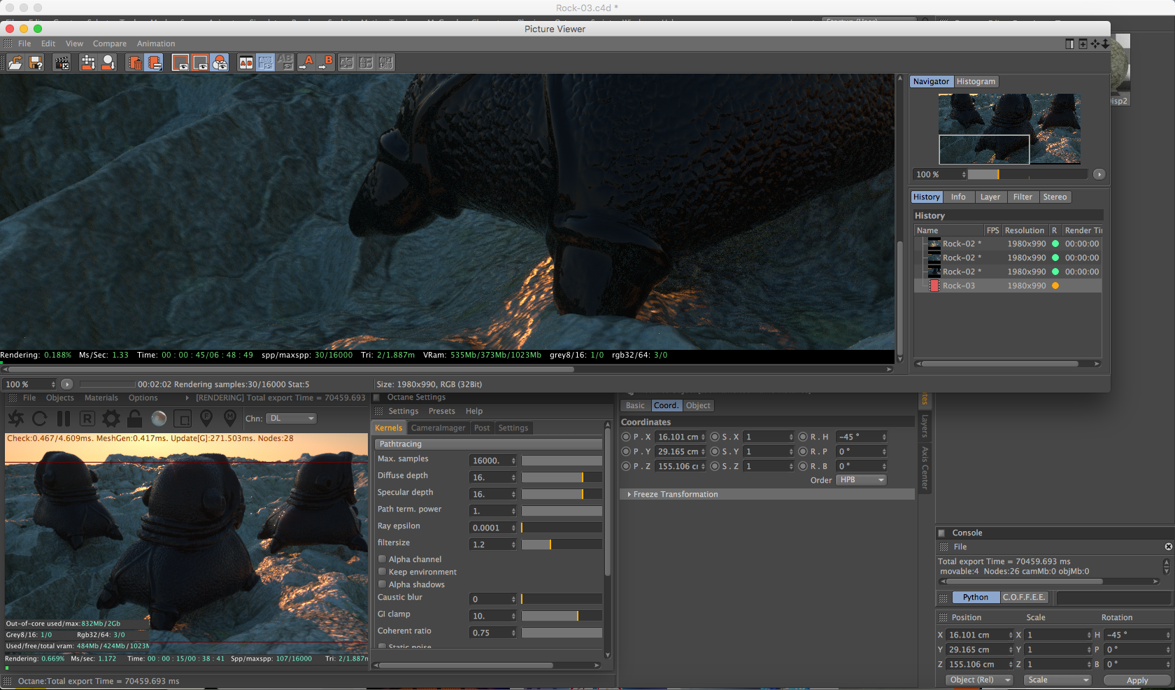

I have a set up similar to yours and I use the out-of-core feature every day. It save me because currently I have only a GTX 560 1GB on my mac. Here is an example (apologize for the messy scene just for testing purpose) with 4x 8k textures and 1.8 m polys: I expect that you can manage more bigger scene with yours set up
Are you using also a monitor connected to your GTX 970 losing some VRAM?
I have a dedicated singol slot GT 120 for monitor only and it helps a lot.
